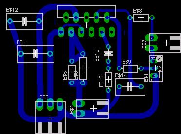

AFAICS:
No feedback resistor between output and -input
No +input resistor connected to ground

feed back resistor is on pins under board, i forgot to show it on the schem.
the input to ground is through the pot to the right marked E$1. as per the schem on national data sheet.

Still, it is IMHO a good thing to add an input resistor, simply because a potentiometer in time wil become affected by wear or may brake the wiperarm (or what's it called?) or maybe even loose contact (dust and/or wear).
Still no diagram? 😕 😡 Else we cannot see, what you are missing out.
And I would put some more capacitors (decoupling) on the board.
Otherwise . . . looks neat .

yes i was going to put some ceramic caps pin to pin under the board as well, what would you recomend for the input res.?? if im using a 10k pot and i picked say a 5k res. would not a 5k paralleled with the pot affect the rest of the circuit?
Board looks OK. Your resistors look at bit small (maybe it's just the image size). Standard 1/4 watt resistors are 4 tenths of an inch (400 mils?) long.
I'd second the idea of adding an input grounding resistor. You can make it 100k or something. That way it will have negligible effect on the pot law, but still offer a DC path to ground to bias the input in the event of momentary jumps.

they are not standard 1/4 watt resistors, they be metal film 1% 0.6 watt, and are the corect pin out size, the pins come out of the bottom, like the poly caps you can get!!!!! and i know you cant get them any more, ive got a small box left over from when i was at the naval yard in portsmouth.
so a 100k res from input pin to signal grnd, can i put that strait accross the pot???

As Richie00boy said, 100k is an OK value. It is of course possible to mount it on the pot, but then you snap a wire . . .
No, put it on the board and save yourself that kind of trouble - and OMHO it is best to put as much as possible on the board, so you don't have problems related to cabling, interference and other things. And there is room on the board for the resistor, so why not put it there?
yes, the pot is mounted on the board as well, i was going to go pin to pin underneath it.
