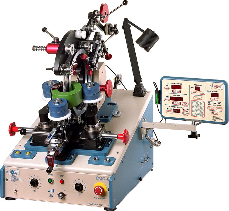

Winding machines for toroid transformers and inductor are pretty amazing and complex (expensive). Look at the picture and you will know what I am talking about🙂

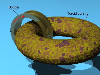

Essentially a toroid winding machine works like this:
A split bobbin is passed through the toroid and closed.
The right amount of wire is then wound onto the bobbin, by spinning the bobbin through the toroid.
The wire is attached to the toroid.
The bobbin is spun again, winding wire onto the toroid, while unwinding from the bobbin.
The empty bobbin is opened and removed.
The whole process is pretty cunning.
A pic of the bobbin/toroid arrangement (thanks to POVRAY!)->
