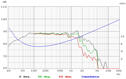

We are building a two-way system with a Peerless CSX 10" woofer and a Peerless 811815 tweeter.
We plan to cross over at 1800 or 1900 Hz.
The centers of the woofer and tweeter are 7.25" apart-approximately one wavelength at 1800 or 1900 Hz, the crossover frequency.
I have done some measurements that seem to indicate that there is positive re-inforcement when the drivers are one wavelength apart at the crossover frequency.
We are attempting slopes of 12 dB/octave each side. Actually, we are thinking of letting the woofer just roll off and use the 12 dB/octave on the tweeter. We would consider 6 dB/octave on the tweeter, but are afraid to have a tweeter that crosses over as low as 1900 Hz with a 6 dB/octave slope. Afraid we might blow the tweeter.
Does having the driver centers one wavelength apart at crossover frequency result in positive reinforcement? If so, how do we handle it-have each driver cross over one quarter wavelength short of 1900 Hz?

To clarify things, here is the response curve for the Peerless CSX 10":
