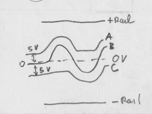

This is what I want to achieve.
Trace B is output audio signal. Trace A is modulated +supply that is always +5V than the output signal (but needs to very sure that it always in phase with B). This A is made by classD. C is the same as A, made by another classD always -5V than B.
The supply rail is very high like +/-120VDC, but with this trick, the power amp B will be working lightly, only from +/-5V supply. The rest of the burden is taken by amp A and C which is classD, efficient.
One may ask, why not making a direct classD amp? Well, this idea is tobe implemented in an existing power amp, any power amp.

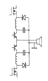

Here is Carver Corporation patent describing requested technology. On the other hand, if you do your tracking converters well enough, you end up with a class D amplifier.
The patent is interesting because it uses active damping of LC filter resonance which can also be applied in any class D amplifier. I have not seen that mentioned anywhere before.

Hi, Here is Carver Corporation patent describing requested technology. On the other hand, if you do your tracking converters well enough, you end up with a class D amplifier.
Rob Williamson (the patent holder) was a friend of mine. I am sad to report that he died quite suddenly and unexpectedly several years ago much too soon (in his early fifties). He, I and another friend had many a late night kitchen table discussion at my house about feedback schemes. Active damping has been occationally used in switching power supplies before Rob's patent. Our discussions on such subjects were the spark that lighted the way to the formulation of my generalized leap frog design method (it can be looked at as active damping for an arbitrary number of filter elements). -- analogspiceman

Hi analog,
thanks for the interesting (and sad) story. Now I understand your familiarity with active damping which seems to be one of the best keept secrets in SMPS and classD industry, especially when all that is required is ultimately only one feedback cap from the output filter cap to the input of the PWM comparator. I would say that even UcD profits from that.

What would the advantages of such an amp be?
Bash uses this method, link providided, and has been discussed here already, link provided. You can see from the Bash website the switching noise on the rails appears on the output as well, the output will be less efficient, and still have whatever cross over distortion it would have had. You're using a more efficient amplifier to aide efficiency in a less efficient amplifier to gain a medium increase in efficiency and all the problems of both topologies combined, with alot more added complexity. I honestly don't see the point to it.

IMO the better efficiency/performance compromise than a switching downconverter and class AB in series like BASH etc would be the paralleling of a high-quality AB amp with a class-d current source.
This would never ever achieve the same efficiency figures as a pure class-d (and would also be more complicated) but it would
- have almost no ripple at its output
- be possible to make a frightenly fast amp this way
