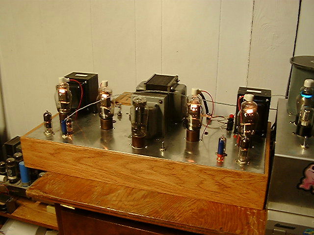

I can't find the John Atwood testing results anymore. Judging by size and primary DCR, 150 mA per side should not get the Iron too warm. Imbalance tolerance is not a spec I have ever found on this Iron.
Here is a pic of them in action.

150mA should suffice for the idea I had.Judging by size and primary DCR, 150 mA per side should not get the Iron too warm. Imbalance tolerance is not a spec I have ever found on this Iron.
Nice.Here is a pic of them in action.
