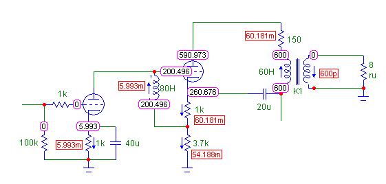

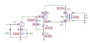

Hi all
Here is an example with a
6SN7 + 2A3.
Required caps. are little but B+ voltage needs to be
quite high.
regards
Federico
thanks for the replies guys. 😉
Federico, thanks for the circuit. it clears up my doubts regarding the current flows.
however, some questions...
i noticed that your 80H choke did not contribute any voltage drop in your circuit. also, the OPT did not have voltage drop.
have the above circuit been built yet?
if so, have you experimented with values other than 20uF for the ultrapath cap?
thanks a lot.
rgds
garbage
hi garbage
excuse me for the confusion.
I only simulate it to clarify things about
current flows. It does not exist, really.
I forgot the choke resitance, while I put
150 Ohm in serie to the OPT to take
count of primary resistance.
I tried some values other than 20u
but without improvements of
freq. response. Maybe other influences
like output res ( as a function of freq.) etc.
I only spent five minutes on it after
reading your interesting post.
If yuo want, I can do some investigation.
I am speaking about simulations obviouly.
bye
Federico

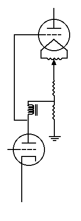

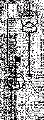

Just think of it as the choke/driver/R3 is parallel with R2. I think the fact that it is drawn up and over rather than heading straight to ground is confusing. The confused approach was assuming current flowing up through R3 and the driver, then back to ground through the choke and R2. Nice trick. If we could only sample some of that ground to ground current, we could save on the electric bill.
Move the driver tube lower on the drawing so the branch through the choke aims downward and it becomes clearer. The power tube grid connection doesn't enter into the current flow question.
You mean something like this?
