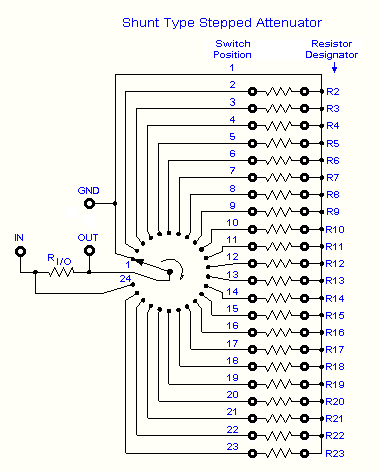

Standard Pot = Series Pot
<a href="http://www.siteswithstyle.com/VoltSecond/12_posistion_shunt/12_Position_Pure_Shunt.html"><img src="http://www.siteswithstyle.com/VoltSecond/12_posistion_shunt/SHUNT_MODE_POT_CONFIG_B.gif" >
</a>
Theres also constant impedance <a href="http://www.geocities.co.jp/Technopolis/5053/amp/t_att.htm"><img src="http://www.geocities.co.jp/Technopolis/5053/amp/20kATT.gif"></a>
Pics are links
James
one resistor in signal path?
(thank you, James)
Am right that , depending on which attenuator you use there is onl oen resistor in signal-path, the switched second resistor goes to ground
That means that i only need to use very high quality resistors for those in signal path and for the others i could use cheper ones without loosing sound quality?
regards,
Ralf

Mine looks that
in this design there is only one resistor in signalpath.
regards,
Ralf

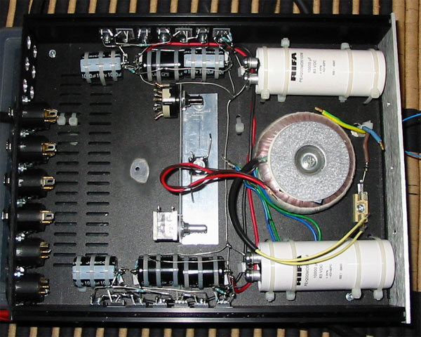

Hi all
I got this attenuator from LCAudio in Denmark, it works very well and it do have a perfect logaritmically attenuation.
Does anybody know about this construction or having any point of views.

i have just ordered DACT CT2-10K-4 for the revision of my BZLS. I have been pondering with this problem for a while, and found that there is no free lunch. The resulting 2,5K output Z halves the HF rolloff point, but I wouln't loose any sleep over it 🙂
BTW, it is nearly finished, so there will be some interesting pics soon, as I have made it in a rather unusual way :wiz:
