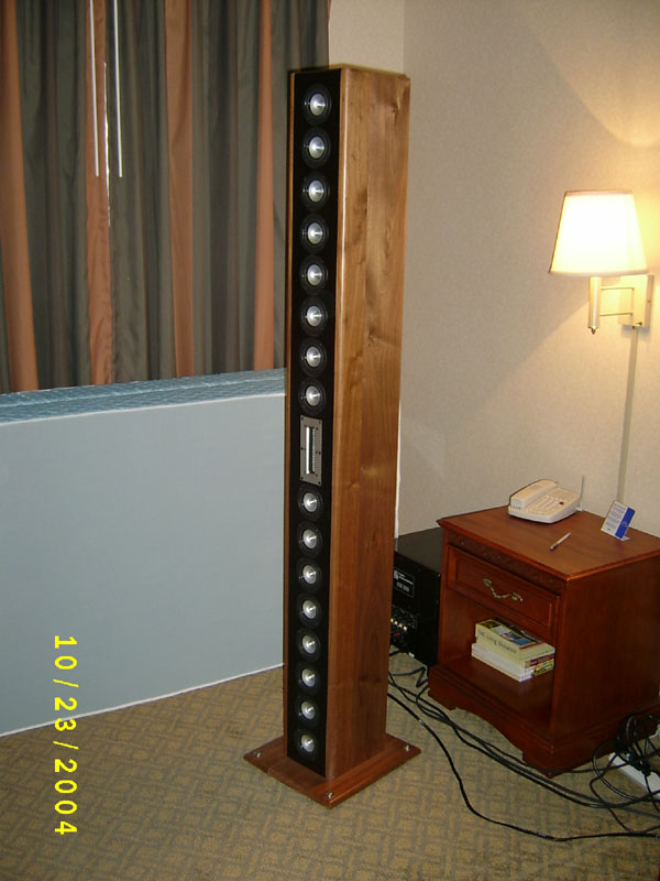

Just got back from the Dayton Ohio DIY speaker meet and was blown away by Jim Griffin's "Needles" line array he had set up in his hotel room. Just thought I'd post a picture of how beautiful these speakers are. I'm 100% sold on line arrays now and don't think I can go back to conventional speakers 😀

Welcome to the club
LA's sound fab. Add Ribbon's to the reason's why those sound amazing.
While people can explain why they sound good in conventional terms, there's no spec I know of that adequately captures the experience.
I just finished a project based on Jim's papers and personal advice (although I didn't take ALL of it, for cost reasons) and I was stunned by the results - having built a lot of speakers in the past. I'm sorry I missed the Dayton Show too - I live in Cinci - so it was close by and I've been wanting to hear Jim's designs.

Thoughts About Needles Design
I recently answered an e-mail on the Needles which deals with your question so here are my thoughts from that message:
The Needles uses a single ribbon tweeter so they operate in both near field for the small woofers and in the far field for the tweeter. In regard to the ribbon tweeter operating in the far field:
Technically, that is correct but remember that a ribbon tweeter like the Aurum-Cantus G3 has limited vertical dispersion so it functions as a mini-line source within its vertical dimension. The Needles would work the best wherein your listening distance is in the 8-16 feet distance range which is where the power radiated by the line of woofers best balance with the ribbon tweeter. The Needles would not be the best solution if you have a large room and listeners are distributed both close and far distances from the sources. This is in contrast to line arrays that operate entirely within the near field for both their woofer and tweeter arrays. In the full range near field design you would have good balance throughput the entire room.
Bottom line the Needles have excellent performance but you have to merge what they do best with your listening room and musical taste. In reality most speakers have you consider many of these same tradeoffs.
The Needles would work great in a situtation such as with a projection screen between them. If you are implementing home theater with multiple channels, I would suggest that you try a phantom center channel approach. A line array--especially
in the near field--will generate a wider coverage for the image between the two speakers so you likely could live with the no center channel tradeoff.
Jim
