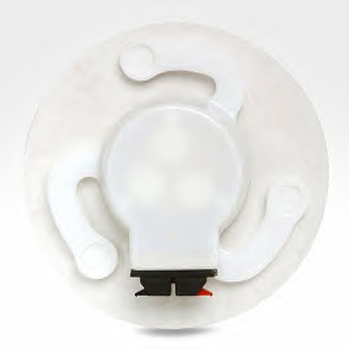

When I got home and opened the package I discovered the "speakers" were actually cardboard cones which were folded flat. They have some type of stick-on motor/transducer/whatever inside.

I've fashioned a couple of cabinets from cardboard to try out things before building a real cabinet and sometimes those cardboard boxes can sound amazingly good. But the weird thing about these speakers is that there isn't any "driver" as such. Just that transducer or whatever stuck onto the inside of the cardboard. Imagine a three sided pyramid about 18" tall made of cardboard.
No openings for drivers, no drivers, nothing. Just cardboard.

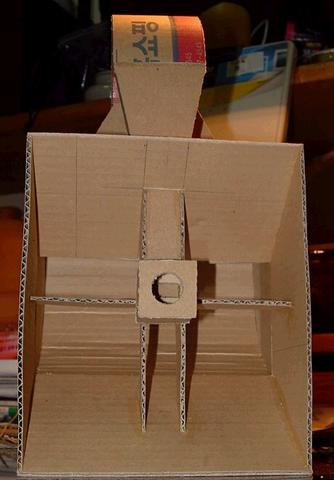

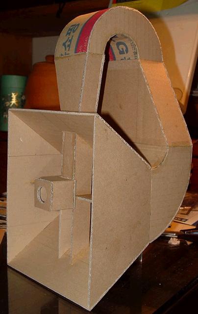

Well, look at this picture someone sent me 😎

Done right cardboard enclosures can actually work...
I made one myself just to prove it could ( or could not) be done.
Its not suitable for subwoofer duty ... I got some interesting rattles below 30hz and near silence at 40hz. but above 60hz it works suprisingly quite well.
And with a decent driver, id even have a keeper. The only problem is it tends to be front-heavy and prone to falling over -- the driver weighs as much as the whole cabinet 😀
Now that horn pic has got me pondering about making one of my own.....

I think those cardboard speakers used NXT technology, "chaotic bending waves" set up in a panel by the "exciter". I have some computer speakers made by TDK which use the same principle. Providing the material has the right stiffness/mass you can use the cheapest one you like. They chose cardboard.🙂
Pretty cool cardboard horn! But, I'm guessing that it still has "regular" drivers.
That's the thing that is amazing (at least to me) about these speakers. No "regular" driver. Recognizing that speakers like Magneplanars etc. also don't have what I normally think of as a regular driver this is something different from that.
Still, that photo tempts me to start cutting up some boxes! 😀

You are right. I've been looking at the "documentation" with the speakers and amp and it is NXT technology. I have a set of flat panel computer speakers (or I did before my son took them to college) based on NXT technology also. But I didn't expect it to work with plain old cardboard! I assumed the panels were specially designed and were more like ribbon speakers.
I went back to the store today thinking I'd pick up another set but they were gone. The guy there said they also had just the "exciters" that you could stick on anything like photographs or posters to turn that thing into a speaker. Of course they were out of those as well. He said they were $10. I'm going to keep looking for that.

I saw these from Sonic Impact on Target's website:
http://www.target.com/gp/detail.html/ref=br_1_20/602-7280254-4702241?_encoding=UTF8&asin=B0001HKVKQ
I would be fun to see what they can really do.
Dave,
Those are the do-hickeys (technical description) that they had in the store and the same things that are stuck on the cardboard speakers I have. I'm going to a client's office in a few minutes and will drive right by a Target store. I'm going to stop in and see if they have any left.

When you buy a license from NXT, you get software to help you design flat response speakers. You will need some experimentation with material, shape and the position of the exciter. You may get some clues by googling.

I'll probably take the exciters out of one set of speakers and try them on different materials.
