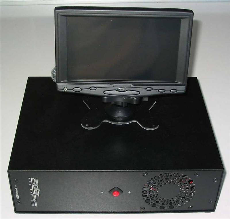

Black casing Lilliput touch screen?
I've just bought a Lilliput that looks exactly the same as shown here except that's the silver version.
I think it's real. The touchscreen can easily be removed so it's no problem. Just make sure that there are no defective pixels (very annoying if projected)
