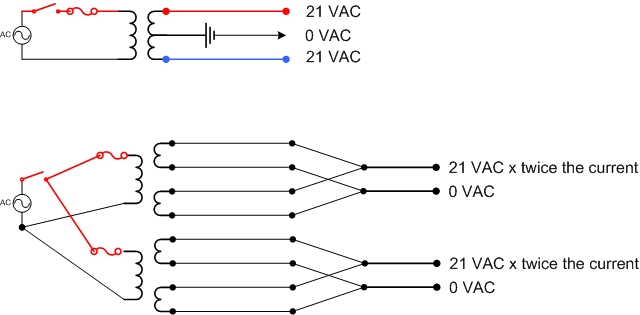

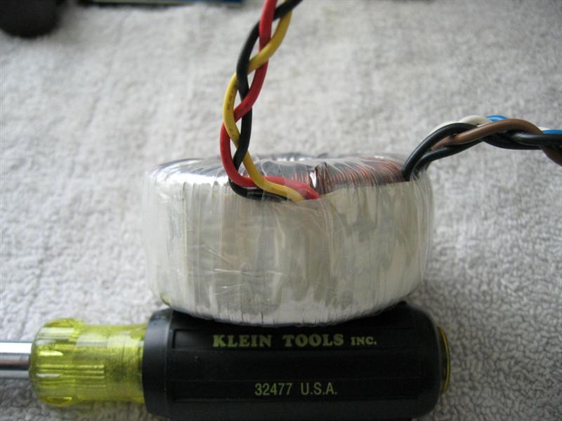

I just converted my transformer from center-tapped to dual secondary.
The pictures are attached one per post.
Please notice in this diagram I added a second xfmr also...
The concept is here:

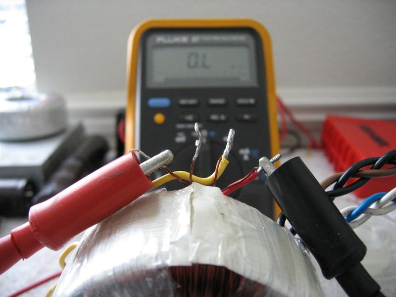

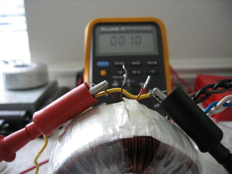

3rd pic of coil end matching.
Fluke set to measure resistance. Value in desplay is 1 Ohm. Different xfmrs will have different values.
At the end will be a picture of the WRONG ends showing "OL" (out of limit) on the volt/Ohm meter.

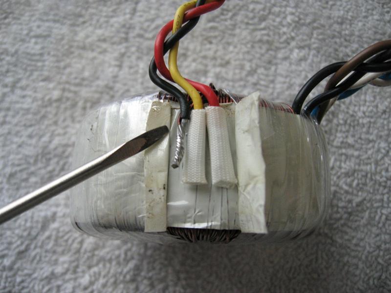

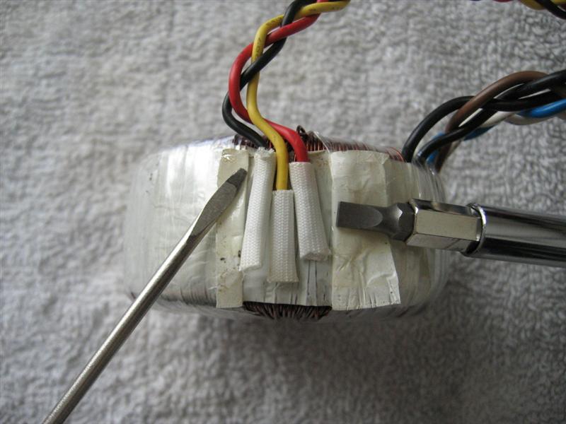

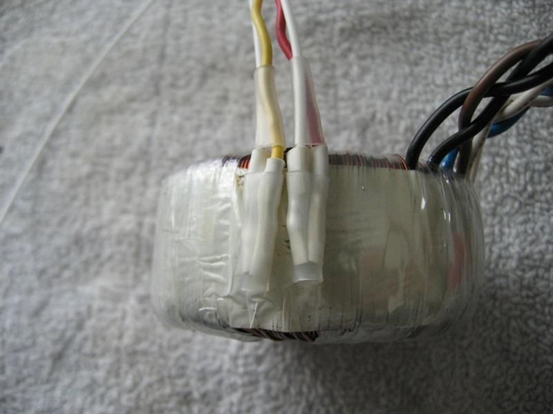

And the center tapped lead un insulated about to be unsoldered.
And yes I did nmean to put this picture higher... Oh yell, I hope you weren't doing it and reading at the same time.... 😀
