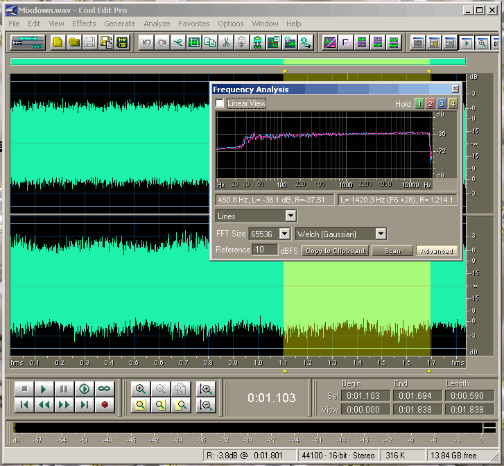

Just when I had connected it to my pc, it did behave normally... but the error's not gone. Guess i will make a living with it... if....if...there wasn't something wrong with the player in general. As an explanation: I bought it very cheap from german ebay for only 12euros ("defect: failing from time to time") as replacement for my marantz63 which totally died. I thought, I would replace laser unit in the naka and that'll do.

Ok, it plays when warm, but sounds rather horrible. Cold, harsh highs, undynamic mids. Ok, its a lot like the old esprit-sonys, but I expected a nakamichi at least to play better than my discman. So I checked it once again with the help of my pc soundcard and adjusted the distortion potis of the ad1864n. Sound stayed the same. I burned some test signals onto cd and got surprised:
applying a fast sine sweep from 20hz to 20khz led to cracks and clicks from the higher mids on - both on the digital out as on the analog out. The drive was rather irritated by the track and had a longer seek time than usual. Single sines are played well except sometimes highs when louder than around -10dB. But the main point was, when I played white noise at -6dB. the amplitude changed between -3dB and around -7db every ~0.3 of a second (link: upper graph original, below from my naka). However, this doesn't happen with sine waves. Some sort of digital signal misbehaviour.
Any idea where this comes from? I had some probs with the mute section (thats why i soldered the trans out), but the pins on dsp and servo proz get low/high as they should. So I don't thinks it's a mute signal irritating the dsp.
Any advice? Otherwise i'll dispose that thing off..., grab my last euros and buy myself a new denon 685/1450 or a nad 521bee

When doing warming to selected ics of the naka, I found out cxa1081s is only working properly when warm. If not, the laser won't try to focus (but dimms red), when getting warm the disc starts to spin and the output crackles (reading without having focussed). When warm, it focusses and plays.
cxa1081s ... anyone knows where I could get a spare??

Why I had the idea to check that? Yesterday I checked all voltages given in the schematic and they were ok. Only the voltages around q101 were wrong as I had +5Volts, +4.3 decreasing to 3.6 during 5secs measuring and 1.3volts decreasing to around .7volts. So I will change q101 and c101 as well.
Heating up this portion of the pcb with a dryer means perfect playing - I had carefully resoldered this whole part of the pcb a week ago, so it can't be a cold pin.
btw: Couldn't hesitate to keep on searching even after I had posted and found a spare. It's listed in the euras-system and I ordered it for 4euros plus 6euros shipping as an "original onkyo spare cxa 1081s". Could have payed 50euros as well. I dont know if it's dip or some other shape. I will heat up my acid, if neccessary to make a carrier pcb...
Doenberg would have also been possible (thanks for the link!) but they're from ireland so more shipping...
