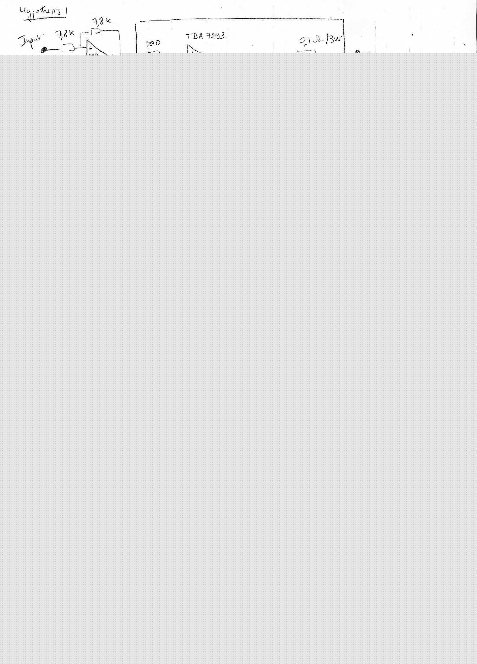

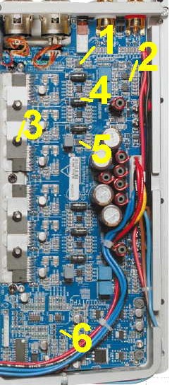

OK, let's give it a try (I won't try the SMPS, because from experience, I know it is a mess to fix) . See the pictures attached
First of all, "1" looks like a balanced to single ended conversion chip, followed by a switch, and obviously this arrangement has been kept on the new Chakra design.
"6" is a bunch of low voltage regulators (for the logic + the buffer?…) + probably a small microcontroller used to monitor the thing.
For the rest, you can see two identical amplifier section, one for each channel.
For each section, there are three TDA7293s all used with the same components. The elco is the bootstrap capacitor, there are also two large SMD caps for IC decoupling, and two small chips close to pin 1 which could be mute transistors used to protect the TDA when switching on/off the input buffer power supply (I thought first that they were used to switch the mute/stdby pin, but then they would rather have been placed on the other side of the TDA). You can see the three 0,1 Ohm epoxy coated wirewound ballast resistors in section "4".
In "4" you also see two ICs, with identical accompanying resistors/caps. In section "5" is another IC, with a different configuration. I first thought that the three Ics, perfectly aligned with the TDAs, were servos (one for each TDA). I now believe that the 2 Ics of section "4" are double op amps used for 1 servo for each of the three TDA + one servo for the section "5" IC, which then would likely be an input buffer. The servos for the TDAs ensure a good current matching between the Ics, reduce the noise and avoid elcos in the signal path. The input buffer gives a decent high output impedance and drives the bipolar inputs of the TDA (relatively high input current + high voltage offset). I'd guess IC "5" is an OPA604, AD797 or alike (FET input, low noise, low offset, stable at unity gain- don't forget that the Linn has 28,6dB total gain, and that the TDA already needs at least 26dB of closed loop gain for stability, this gives little remaining gain for the buffer stage, except if there are some dividers somewhere in the circuit).
Questions I have:
-are the TDAs are used in inverting or non inverting configuration? (my guess: not inverted)
-same question for the input buffer (although I would guess it is inverting because the input impedance of the amp is low: 7,8 k!)
-is the TDA based gain stage included in the input op amp closed loop or not (if yes the combination creates a high performance high power op amp, but you have to be careful with stability)? Personnally, this is the one I would try!
-what is section 2? Another buffer (overkill!)? Or a signal detector used to switch automatically on/off the thing (but then why these nice, expensive, blue plastic caps? And why one section for each channel?)
Has anyone any clue? Has anybody opened the little Linn Klimax box and had a look at the IC references?
Attached in the other picture, some drawing thoughts (with a tube buffer IGC variation).

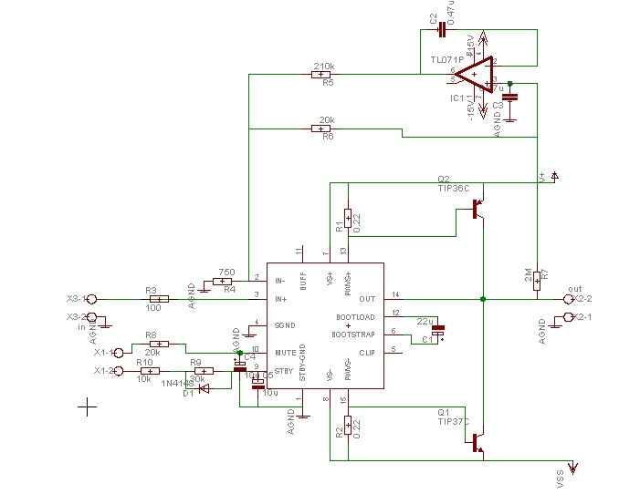

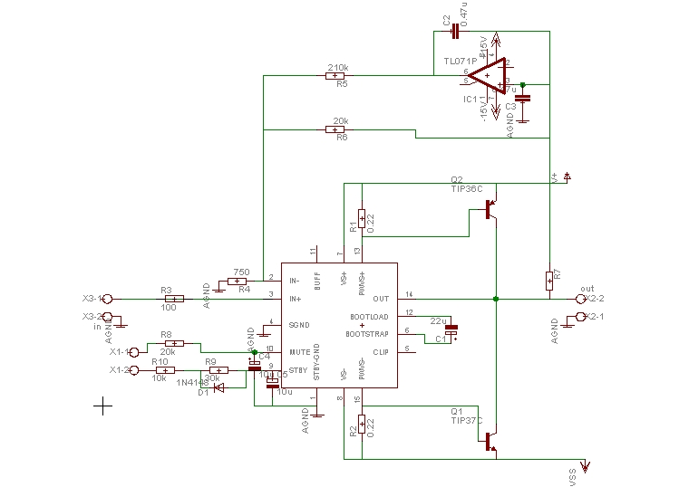

TDA7293 with TIPxx Power Transistors
It's been nearly 6 years since the last post on this thread. I'm hoping everyone is still connected to this thread.
That's an interesting design from borgard with the TDA7293 driving a couple of BJTs to boost its output power. I think he mislabeled one of the output transistors. The NPN transistor should probably be a TIP35C and not a TIP37C. I don't think TIP37C is a valid part number, and the TIP35C is the complement to the TIP36C PNP transistor.
Is this really what Linn did? Has anyone tried this particular circuit out? If this works as shown, I'm wondering if it's possible to simplify it further by getting rid of the TL071 op-amp circuit? Any reason for that low-pass filter in the feedback loop? The original ST datasheet does not show this in the circuit. It's hard to see the + input capacitor in your drawing, but I think that's a 0.47uF, right? Any opinions about this?
I see that the feedback decoupling capacitor, C2 in the datasheet, was omitted. That's certainly easy enough to include.
I'm looking for a very cheap power amp that I can use in various projects, and this looks like a winner if it works as expected. The cost of these semiconductor parts is crazy low, and I like the idea of using discrete transistors to boost power as opposed to slaving the TDA7293s. You get more bang for the buck plus the PCB artwork is a lot easier.
Please let me know how this worked for you and if you've experimented any with it.

I think there is an error in the schematic post13.
R6, the upper feedback resistor, connects to the top of R7.
Should R6 connect to the bottom of R7?
The amp is DC coupled.
The opamp is a DCservo to minimise output offset.
This opamp signal needs filtering to allow audio to pass through the main amp unaffected and for VLF & DC signals to be processed.
Ah yes, you are absolutely correct. Good eye! Connecting R6 to the top of R7 would make the gain unreasonably high.
Is there a resistor missing from the (-) input of the op-amp? Should be a resistor to analog ground, right?
the +-15V supply to the DC servo limits the applied DC correction to ~+-46mV.
Does any one know what Linn does to limit damage if the TL servo cannot correct all the input error?
Yes, the grounding resistor on -IN is missing.
