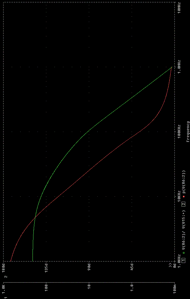

On the open-loop gain diagram one can see that the whole loop has a first-order behaviour (well, almost) and the unity-gain point is 200 kHz approx. Phase-marging is 80 degrees approx !

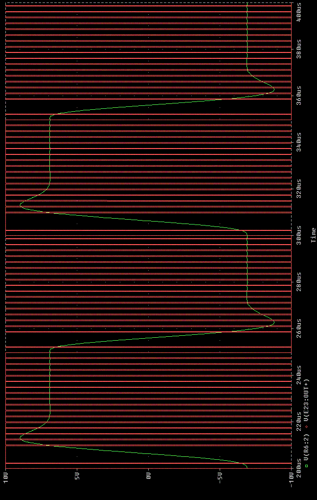

The simulation I would trust the least is the transient analysis (i.e. the THD part to be exact). One can see the output signal when driven 20 dB below full output. There is not very much of the carrier left over ! The FFT shows that all harmonics of the "payload" are suppressed by more than 80 dB.
While the topology as such would theoretically work it is still not complete and it would show a "dangerous" restriction, depending on the input signal. I will elaborate on this later. Everybody is invited though to find that one out by himself in the meantime !

The secret:
The circuit uses zeoes to cancel the output filters poles in advance. The closed loop has a behaviour of a 1st ordee lowpass after the bottleneck of a 4th order filter.
This is asking for trouble with fast transients and/or strong high-frequency content. Therefore one has to consider an additional lowpass filter before the amp, depending on application (a CD player wouldn't mean real danger but DVD-A and SACD probably could).
Regards
Charles

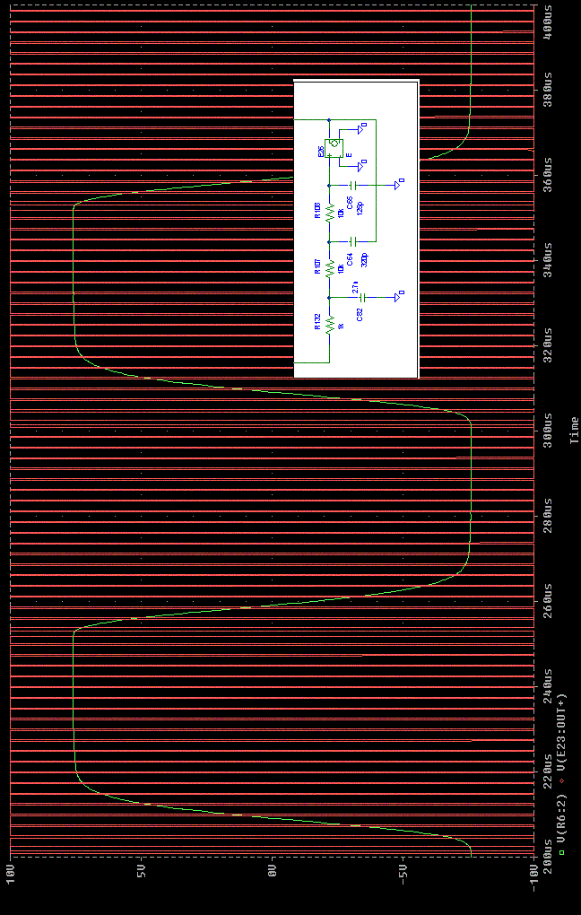

Thats how it would behave with a lowpass filter "in front". The filter is designed such that the overall response of the amp would be the same as the output filter alone would give.
One can see that the transient overload problem is significantely reduced (10 kHZ rectangular).
Regards
Charles

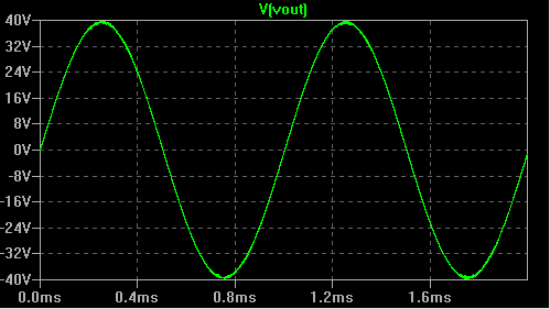

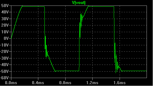

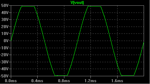

Hi Genometrics
What type of amp did you simulate ? The behaviour looks like expected from a higher order forward-path topology like the one used within higher order ds-modulators. Is it ?

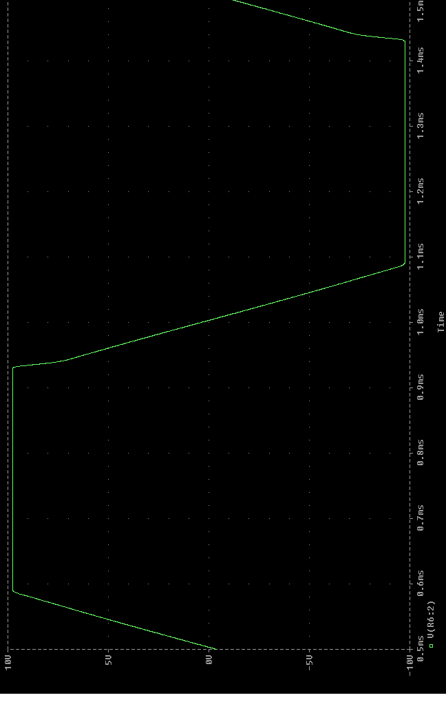

The picture below shows what I got when I made a simulation of "my" amp overdriven by 6 dB. It also shows a slight tendency to "stick to the rails" but not very severe, but precautions would have to be taken anyway since the user expects "normal" behaviour from an amp in every situation.
One would have to use a double- or higher- order loop for getting good THD and IMD with this amp, and then the same behaviour accounts as for your the amp that you simulated.
