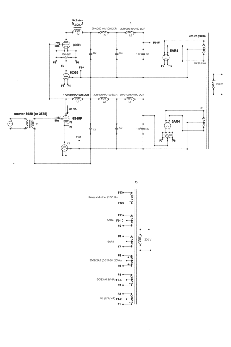

I’d like to submit and discuss the schematic of an integrated amplifier (direct connected to a CD-player … without pre).
We (no-profit association – Agorà) would like to realize this project together with the child that take part to the “Corso di Elettronica” (electronic course, promoted by our association).
Since I’m not an expert in Electronic, I’d be very grateful if somebody could help us in this adventure.
Points to be defined:
Current setting of 6S45P and bias of 300B:
1) 15-20 mA …with “combined” anode load (H + R; i.e. H=50H/400DCR+ R=3.000 ohm).
2) 35 mA … with “pure” choke anode load (i.e. 170H/2000DCR).
6S45P-Bias:
1) vacuum tube diode on the cathode (which one?).
2) battery on the cathode.
3) RC on the cathode.
4) RC on the cathode (with R being a potentiometer … in order to match the two 6S45P).
Input transformer:
1) Sowther 3575 in configuration 1:1
2) Sowther 8920 in configuration 1:1 having the two secondary in parallel.
3) Sowther 8920 in configuration 1:2 … with a less power input-driver tube (i.e. ECC99).
Power supply:
1) L2 and L4 --> 30H/100mA/190DCR
2) V ?
3) C1=160 uF, C3=80 uF, C5=1 uF

Nice looking project!
6S45
I don't quite understand the need for a combined choke. If it's purely dc considerations it is possible to adjust the anode voltage as you have a separate PS. For 6S45 even 50H would suffice IMO.
So my choice would be 50H @15mA.
6S45 bias
Vacuum tube? Don't think any will give you such a low bias at 15mA, let alone 35mA. If you still think you must use it try several 80 in parallel (2-4?)
IME rechargable batteries work well with the 6S45. Just don't ask what type as they all sound annoyingly different (as capacitors) in this position. As you have an input transformer it may be a much better sonic solution to connect the battery in series with the transformer windings.

Re: An intriguing 6S45P direct coulpled 300B amplifier
Konnichiwa,
From experience with the 6S45-PE, you may find neither chosen operating point too good sounding. I would recommend 170V/10mA as a starting point for optimisation.
In my experience and if the desire is not to exploit the maximum power of the 300B, try 350V/60mA/5K load with 74V Bias. Then consider the use of one or two LNR Diodes, carefully matched to the circuit (that requires access to serious Audio Analyser and the skills to use it, plus a box full of different diodes). If you are not certain how select the correct LNR diode, leave them out as the wrong diode will make things worse rather than better.
May I suggest a better solution entierly? Battery on Grid. As you already have intended an input transformer (for an integrated amplifier unit a Volume Control Transformer may be a better choice) just place the battery in the ground lead of the Transformer making sure to bypass the battery with a capacitor.
The 6S45 choke loaded will allow the required 74V Peak at around 0.5% 2nd harmonics, so the driver stage will be very linear, using a LNR Diode will not likely make things significantly better.
Then to correctly Bias the 300B add a small adjustable resistor in series with the 6S45-PE Anode Load choke which allows the 300B Bias to be trimmed.
The suggested operating points will allow around 6 - 7 Watt RMS @ 5% THD (mostly 2nd Harmonics) without using LNR Diodes and will require around 1.3V RMS for full output with a 1:1 Input connection.
Sayonara

Are you sure that a 5AR4 is the correct rectifier for the 6C45 B+? I don't see how you can draw the B+ from its center-tapped filament.

you can take B+ ad libitum from either side of the DH rctf. eliminating the pot (or two matched R's), it does not change anything except you get better and more equall and linear exploatation of the rctf. cathode, compairing with the case when it's taken from one side.Or better try a separate,good, with e- static shield,bifillary wound heater T/X!!

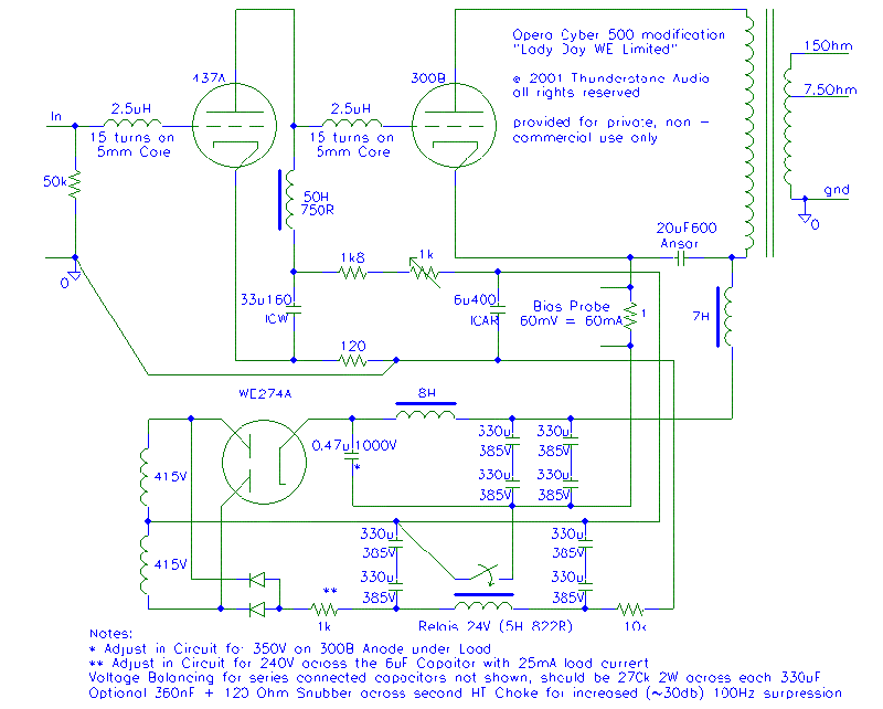

I have attached a Circuit I did some partial testing for and which should work pretty well, but which I never quite got around to complete which might be of interrest to you.
Sayonara
Sayonara
Antonio, I think the circuit you are investigating has the advantage---and perhaps a significant advantage at that---of providing a degree of PSU noise cancellation. Any non-signal related PSU disturbances will show up on the grid and cathode of the 300B, cancelling to the degree those disturbances are not reduced by your driver anode choke. Elegant indeed.
I do not understand the problem with 5AR4 ...
My mistake. I have been playing with 6V rectifiers and damper diodes so much lately that I'd forgotten the cathode is tied to the filament on 5V ones.
John

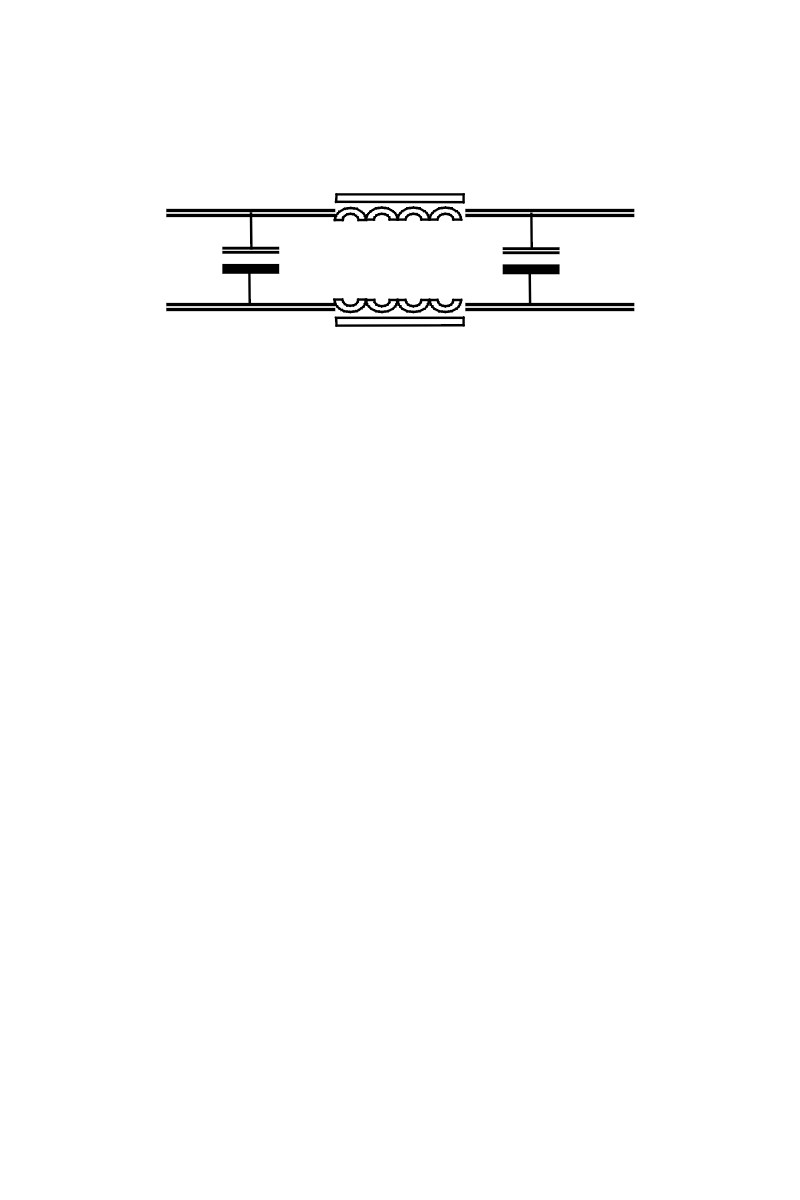

… very interesting suggestions ! However, I’d like to submit some specific questions about them.
If so … is your proposal substantially different from the split chokes in a “hum bucking” configuration (providing phase cancellation of hum and noise) proposed by others ?

As I have build a few DC coupled Amp's where the Bias relied on the driver circuit I would not want to be withoput this type of interlock.
Not? Look at this schematic:
This shows one of the two +B Chokes (the one marked FC-6 which is a 6H "Wideband" Choke) connected in that fashion.
I am not sure what "hum bucking" confiuration you refer to. Any reference?

In my Schematic above the Winding is basically 7V (lengthy and difficult to explain, so don't ask).
In a new implementation I am using 8V tapped at 5V & 2.5V AC to be Schottky rectified and to allow CRC/CLC Filtering with adjustable Heater Voltage for 4V/5V/7.5V DC (PX-4/PX-25; 300B/50; 10/10Y) with also options for 2.5 & 5V AC.
Antonio Tucci said:It is no clear the use and the configuration of the custom chokes you suggested.
Antonio Tucci said:If so … is your proposal substantially different from the split chokes in a “hum bucking” configuration (providing phase cancellation of hum and noise) proposed by others ?

Which characteristics must have the secondary for the 300B heaters ?
I'd have contemplated to request a secondary with the following charcteristics: 4A and 2.5V, 5.0V, 7.0V center tapped.
Is it correct ? .. or do you suggest 4A and 2.5V, 5.0V, 8.0V center tapped ?

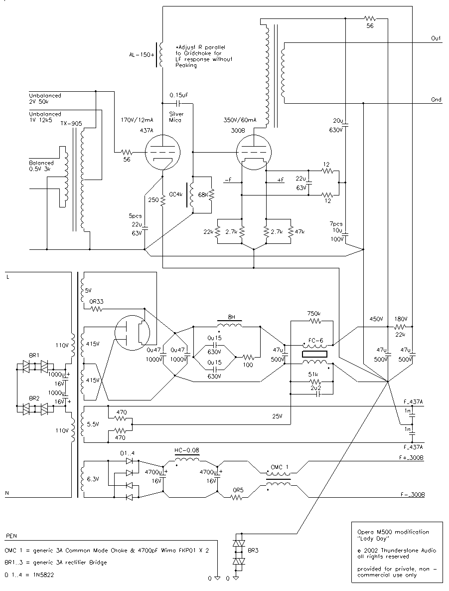

Here is a reference:I am not sure what "hum bucking" confiuration you refer to. Any reference?
http://home.att.net/~chimeraone/axiom300bdesigninfo.html

I would recommedn 0-2.5V-5V-8V @ 4A
This gives 2.5V, 5V, 5.5V & 8V AC, to allow a lot of different Valves with AC and DC Heaters.
I don't see any special in the use of Chokes in the Axiom. Looks to me just like a fancy name for using an LCLCL filter instead of CLC.

Antonio Tucci said:Which characteristics must have the secondary for the 300B heaters ?
Antonio Tucci said:Here is a reference:
