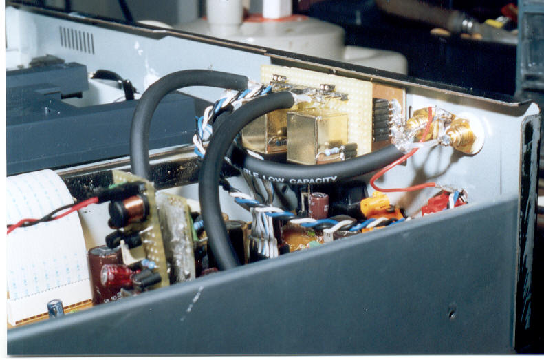

Hi Richard,
in the photo the output tranny of my XB720. They directly couple the dac to RCA, just with 8 68hom resistors and a 1.6n cap.
You can also see the Tent's clock and the discrete regulator for the dac. Dac and clock both has their own PS and regulator.
The sound of this CDP is very good, bur actually I prefer the sound of a Teac VRDS8 with a discrete fet IV and output stage, and Kwak's clock. Much more impressive, expecially in the bass side, but anyway the Sony in his price class is really a very well sounding CDP.
