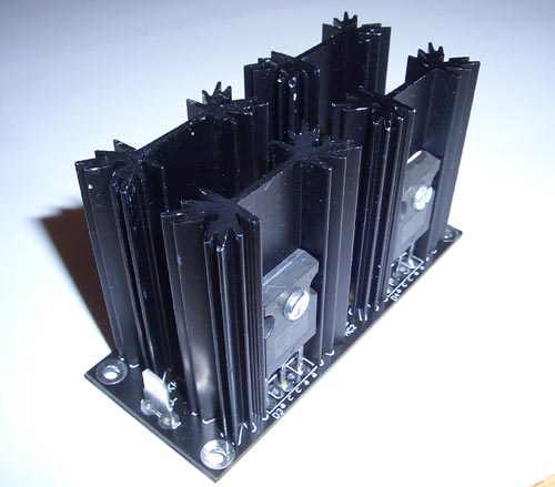

What I will be doing here is offering up a board very similar to that which was made last time round which will accommodate a set of ultra fast switching diodes (either dual TO-247 devices, or single TO-220) along with a snubbing network and space four heat sinks etc.
There will be some minimum order numbers which I will have to hit before this becomes worthwhile doing though, which would be 100 of the PCB’s and at least 25 full set’s of component kits (although again like last time I will try and supply the spade PCB connectors as I’m not sure how easy these will be for people to et hold of individually)
You can see a picture of the board in an assembled state at the end of this little lot of text, and I will include a description of the components which would be in the kit on the wiki page which I will go and set up now to try and gauge interest in doing this again, but if any people have any questions about things then feel free to post on here and I will try and answer them as quickly as possible (which also goes for the pricing which I will have to go off and work out for the component kits now, but which would probably remain at £4 per PCB as it was last time so long as the board house don’t’ charge me any more this time).

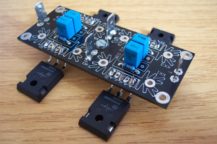

Just one more picture to give a clearer look at teh PCB and show the alternate method for cooling if you want to put a lot of current through the diodes.

I only want to remind you that your insulation distances are too small. I recommend that you increase them to 1 mm or more. Calculate for max voltage 200 volts at least.
You may also place the pads in zick-zack so you get more space. What don't you place the e TO220 devices a bit from the heatsink. It's easier to bend these TO220's compared to the TO247's.

Hi, as this is a fairly generic PCB allowing you to use any suitable connected single TO-220 or double TO-247 diode type package you should be able to find a device which will do what you want it to for your amp (the diodes that were in the kits last time were the ones that are used int he PASS labs amplifiers so they should be a good starting point for you to look at).
Also, the way the PCB is configured, it is equaly possible to use one or two of them for a single supply (so long as you have dual secondaries on your transformer which it looks like you have) depending on what you fancy putting into your amp.
Anyway, hope this has answerd your questions, but if it's not specific enough, just let me know and I'll try to clarify things a bit more.

You can very easily use a centre tapped transformer with one of these boards, it's just that if you want to be extravagent and use two boards in one power suply then you should have proper dual secondaries.
And Clarkcr, the main advantage of the TO-247 devices is that they can generaly handle far higher curents than the TO-220 devices (as well as dissipating more power from the larger package) so in larger supplys like it sounds you have for your aleph both of these things could be considered benifits. Also, Personaly I would always try and over rate the voltge on the parts I am using in an application like this to double the voltage that they will generaly have applied to them (so in your case I would go with a minumum of 100V, but probably a lot more, just to give a bit of protection against any possible short voltage spikes which may get passed through the transformer from the mains). Other than that, from what people seem to have said on here it is quite often a matter of preference as to what sort of diode to go for, although getting a decent part from a technical point of view can have benifits too.
