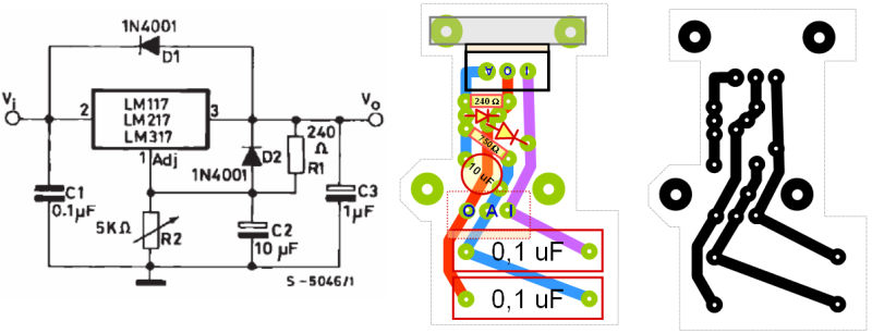

1st problem LM317
I'm trying to replace CD player's LM7805 regulator with simple LM317 regulator circuit:
I used 240 ohms for R1 and 750 ohms for R2.
The pin order for LM7805 (in, out, gnd) and LM317 (adj, out, in) is different.
I connected the pins and resistors like this:
http://kotiweb.kotiportti.fi/audiovideo/download/kytkenta2.jpg
I tested the regulator with 1 kohm and 47 ohm load and I had a 9 volt battery as a powersupply. The voltage was first 5.8 and started getting higher. I had a 4,7 uF cap between putput and ground. No other caps.
2nd problem LM7808
I'm building a simple regulator for Tentlabs XO clock. I used this PCB:
http://kotiweb.kotiportti.fi/audiovideo/download/piirilevy3.gif
Again the voltage was first over 5 V (should be 3.3 V) and started getting higher every second.
I've tried everything and searched half the internet for a solution. You people are pretty much my last hope. Please help !! :bawling:
LM317 is going to be installed to replace this:
I add nothing else but the regulator with the two resistors (no diode). I haven't tried it yet in the cd player.
LM7808 is connected to that circuit. There is nothing else in it. PSU is going to be unregulared 16 V DC.

2 DIAR: To probelm #2: It's hard to read the circuit for me just by seeing the board, and no shcematic.
AFAIK the 7808, the mounting in the board should be the following: metal cooling fin should be facing the 100 uF caps (if the metal is facing to the "outer" border of the printed circuit board, IN and OUT are reversed forthe 7808 -- this might be the reason for the voltage change.
Let us know how things turn out, pls.
LM7808 schematic can be seen here:
http://www.tentlabs.com/ProductEntities/XO/XO.html
I noticed the wrong pin order. I made the pcb but I haven't tested it yet.

The PCB layout is attached.

2 DIAR,
thank you for the website link.
Well, I can't understand why they do so much efforts to propose this circuit for genrating the Supply voltage for the XO:
Datasheet says 5 V +/- 5 %.
So you can simply use 1 7805 regulator, 100uF at input, 10 uF at output -- voila - 5 V with 3 parts.
The original circuit is much more effort, and leaves you with a little bit lower noise level on the +5V rail -- but that's not relvant for the XO.
BTW: If you "burn" the regulator IC's than it is very very shure that there is a problem with your pinout on the board. If I run into this, I let a freind look at the board -- people that are not involved in the project see faults in secounds where I fail for days not seeing these.
2 DIAR:
Looks like got a "limit batch" of LM317: Datasheet specifies a param "minimum load", which is 5 mA typ, -- so the 240 ohms @ 1,2 V is alright. 10 mA is maximum
Your LM317 seems to need appr. 8mA (the 5 from the voltage divder and the appr. 3.5 mA fro mthe 700 Ohm).
So you are little bit out of params - no problem, but took you a long time to figure out. congratulations and happy DIYing!
I must say, I didn't quite understand everything you were saying :cannotbe:
I suppose that you just made sure that everyhing is in order :confused: (If so, thank you very much :D ).
I checked the data sheet and I believe everything is ok.
Vref is ([5/(240+740)]*240) = 1,22 V (should be 1,2 - 1,3 ?)
Test load was 5V/700 ohms = 7 mA + 5 mA --> 12 mA (from R1 and R2). Minimum load is 10 mA ?
--> Everything is ok :confused:

2 DIAR:
well, it's ok if you don't understand it what I try to tell: This parameter is quite seldom discussed.
To get get a common basis for discussion, please look at this datasheet: http://www.age.et.tu-dresden.de/datasheets/V-Reg/LM317_ST.pdf
You should now see a LM317 datasheet.
Scroll to page 3, search for parameter I o (min), minimum load current.
check the very rightmost colummn: 10 mA max.
So this means: Typical value is 5 mA ( column left from the 10mA entry, but manufacturer garantees only 10mA.
What consequences has this foryou as the builder of the circuit? Ok, a minimum load of 10 mA has to be maintained to ENSURE regulation. A minimum load of 5mA is TYPICALLY enough.
In your circuit, with your specific components, we checked by your expereiments that you need at least 7 mA. That's why I wrote : You got a limit batch of LM317.
OKAy, what does this mean in GENAERAL?
This means that forthe standard application circuit with the 240 Ohms resitor between output and ADj. pin, only 5mA current flow. This is okay in MOST of the LM317.
But if you want to make SHURE that in every circuit at every time this will work, you have TO CHANGE TO 120 OHM!!
This is is a typo in most of the datasheeet, and -- bad luck -- most of use stumble into this sooner or later. I did too :)
Or, DIAR, for you: NOT EVERYTHING is okay. BUT if you change the 700 Ohm load to a 470, you have a total MINIMUM load of appr. 11 mA. THIS IS OKAY for EVERY situation (temp. change, input voltage variation): regulation will be maintained.
I hope this shades some light in my former posting. In case there are still questions, don't hesitate to ask pls.
