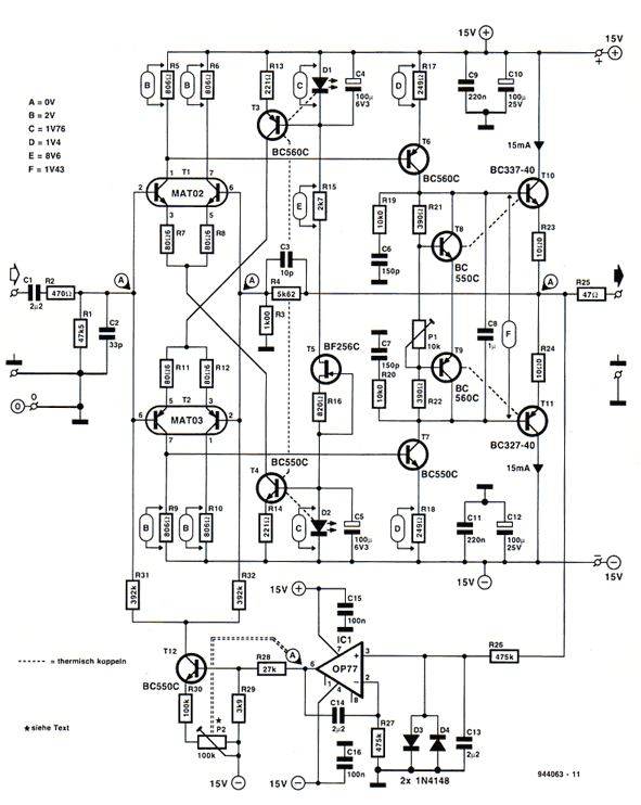

Dear Samuel!
I found a schematic in the Elektor's summer issue 1994. I think this is the drawing you mentioned.
Greetings from Vienna.
Wopo

Wopo, thanks so much for the effort to locate this schematic and post it. The one that you posted is the one with the servo control to null output DC. If you don't mind, could you please look for the one without the servo but a simple PRESET in the negative half of the circuit for DC offset adjustment. Thanks again.

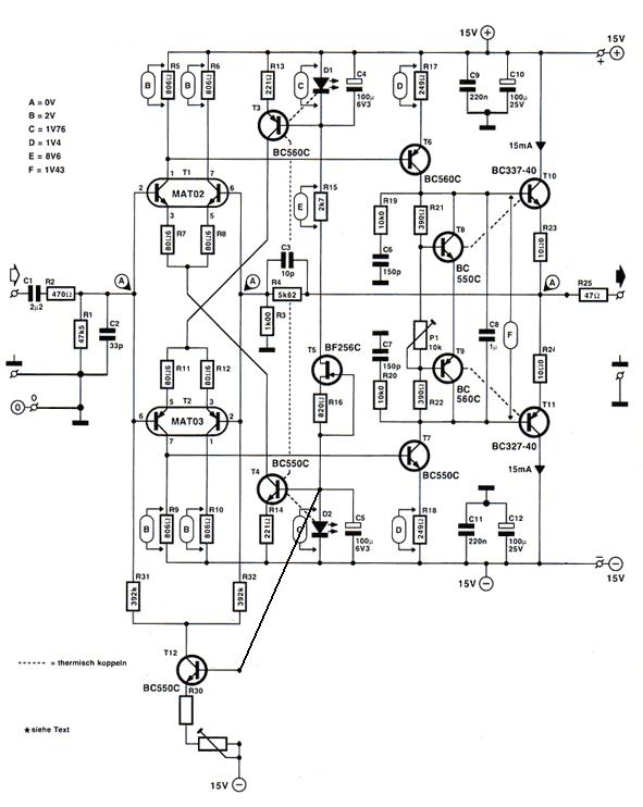

The preamp in question here is NOT that one but the ones posted on page 1 of this thread by wopo and moamps on my request. It is a totally discrete class A preamp line stage which utilises MAT02 and MAT03 for the input differential pair.
If it is possible, try out this preamp. It is simply fabulous.

Hello Samuel,
I have build this preamplifier about a year ago,
(the one with the bias servo) and I also think it is the best I have ever heard.
It is a pity that the MAT02-03's are out of production.
The sound is very detailed and transparent, I use on the input side the "The first cable" of van den Hull, and on the output a MIT terminator II cable, and as power amplifier I use an own design, based on differential input and 2SC5200/2SA1943 output transistors.
I have tested much combinations, but according to me (my taste
😀 ), this is the best combination.
