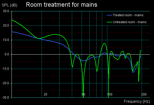

Ok here's my attempt:
firstly since your room is very solid, the modes will be nasty as shown in the chart. With some treatment, it looks a lot more tame.
This is shown for a guessed seating position a little further back from the middle of the room, sitting 3.5 m from the rear wall with the longest axis being from the front to back walls. This response is for your main speakers placed out from the rear wall and in from the corners.

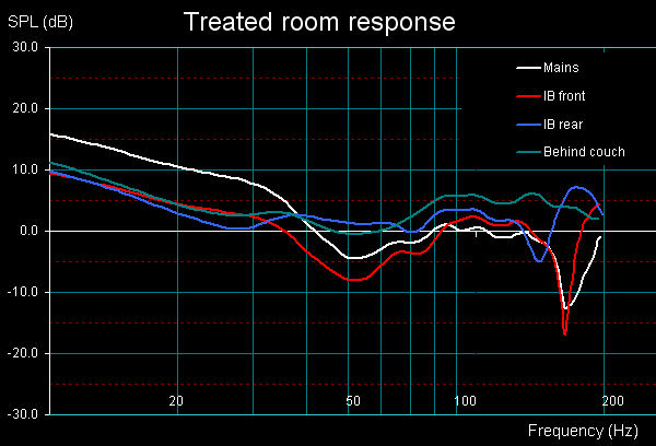

Now for some options. Assuming extensive treatment is used for the bass ...
IB works best if you are relatively close ie. if you are 3.5 m from the wall behind your speakers and the IB is in the rear corner. I also showed (green line) what would happen if you placed your sub directly behind the couch - not as good as I expected.
If the room is treated then the IB option seems to work about as good as anything you will likely find.
The room treatment would need to be extensive to get the results as shown. I modelled the room firstly with a reflectance of 0.9 for the floor, 0.7 for front and back walls and 0.8 for all other surfaces as the room is solid. With treatment I modelled with 0.5 for all but the floor. If you don't use treatment then you would need eq no matter where you place your sub. Probably best to do both.

No matter if you use a dipole or box the pressure will build up in the corners as a function of direct radiation and energy build up/resonance/standing wave.
The reactive function of a helmholtzabsorber or a panel/membrane absorber (or the resistive function of a pile of fiberglass) will be the same for a pressure variation
(= soundwave) that builds up on it no matter what thingy we have to create the sound in the first place.
Even though we call dipoles velocity sources and boxes pressure sources, they are still both devices that creates waves of pressurized air that fluctuate and travels in space.
The only thing that separates the two types of speakers from eachother once we are "outside" of the speaker itself, is the radiation pattern.
/Peter
Peter,
what you say is true - if it's there, the bass trap will absorb it but ...
as I understand, monopoles have maximum pressure in corners in particular, while dipoles create maximum pressure in different parts of the room ... hence bass traps will not work as effectively for dipoles, and you may need more of them to achieve the same effect.
Now that I'm writing this, I realise that I don't really know if this is true or not, I obviously need to look into this more ...
