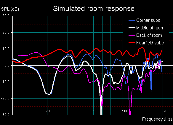

Out of curiosity I modelled your room in the FRD room reflection calculator, assuming a listening position in the middle of the room seated. What I found was that the bass dips quickly below 100 Hz until about 50 Hz. If you had early bass rolloff then this would kill whatever bass you do have and by the time you get to 50 Hz there is so much rolloff that it's all gone.
If you put subs under the mains you will have to eq to get it flat.
Note: magenta curve shows the response further back in the room.
The red curve shows the response you get when the subs are 1m either side of you, much less impacted by the room.
Please note: this is a fairly crude simulation and will only give some ideas of what *might* be happening.
It is interesting to note that with the subs up close, the response is so smooth you don't need much eq. The only problem with this approach is where you have distortion, this enables localisation and suddenly the bass will be coming from the subs rather than being coherent with the mains. I suspect this is something that you could fix with digital delay which you have on the Ultracurve, which would probably not otherwise be required.

Here's a chart showing the simulation:
