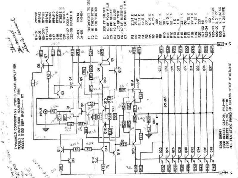

I need help, I have a Thresold S300 with some bad outputs transistos. Unfortunately the Motorola part number has been removed. If any ones knows the NPN and NPN part number I sure would appreciate it. Of course this amp was designed by Mr. Pass
a long time ago. It bit the dust trying to drive a pair of one ohm Apogee speakers.
JW
Outputs on the S-500 were MJ15022 and MJ15023, drivers for the bank were one of the opposite polarity. As far as I know, the S-300 was just a scaled down S-500. I had a channel pop out on me once upon a time just because of cosmic rays (woofer panels on Magneplanar T-IVs, real tame 4 ohm resistive load--just playing background music levels at the time), and got the info from the tech critter at Threshold. No schematics on hand, unfortunately. I spent a bit reverse engineering the front end to figure out what all had blown and why, 'cause when the output went, it ripped all the way back up into the front end. After replacing all the transistors and resistors, it still didn't work. Turned out it was a tantulum cap with a voltage rating of something like 25V. When the front end blew, the voltage spiked (rails on the 500s are over 70 volts) and killed the silly cap. Given that the cap was something tiny like .15uF, I just put in a 100V Mylar cap.

Threshold Transistors
Thanks for the feedback, I've been going to fix this amp for years
now but started listen to another amp. I've repaired the amp several times before, but lost the transistors part numbers.
Anyway, the failure was caused by driving a pair of ONE ohm Apogee Sintilla's. I've given up on the Apogee speakers since the cat got the bass ribbon, their now room dividers.
I have the schematic for the Stasis series and wanted to share it. Mr. Pass sent it to me a long time ago. Back then, I was in the process of changing the collector output resistors from 1 to .68 ohm to to increase the output current land decrease the power loss, hoping this might increase the life of the outputs.
Thanks from your help
