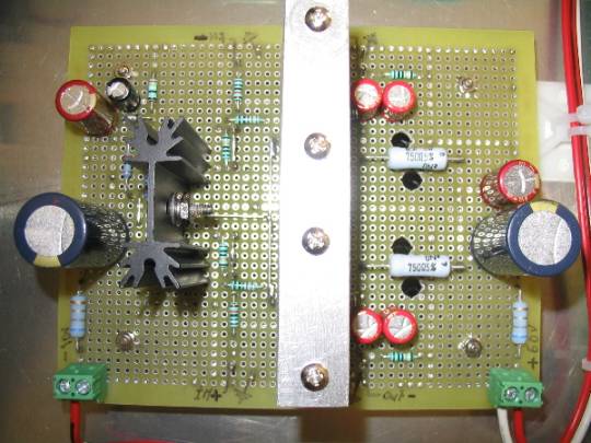

I have already listened to the last prototype, same position of components,
and same values, the results were good, better than what I expected at first.

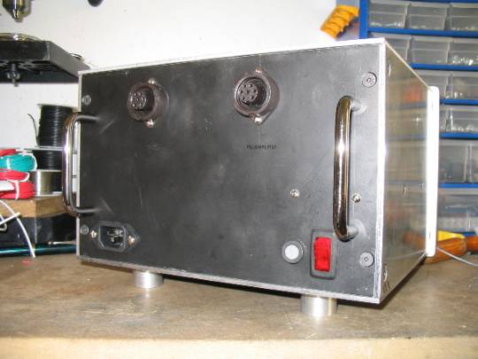

How your's sound? The case is also wonderful! Did you hand made yourself?

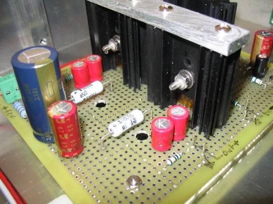

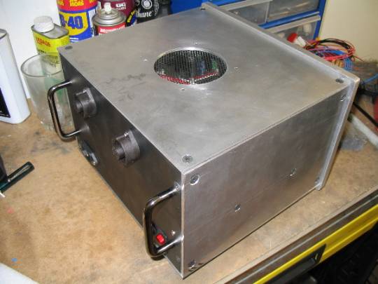

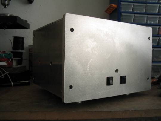

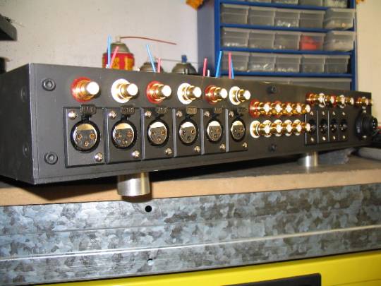

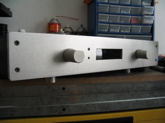

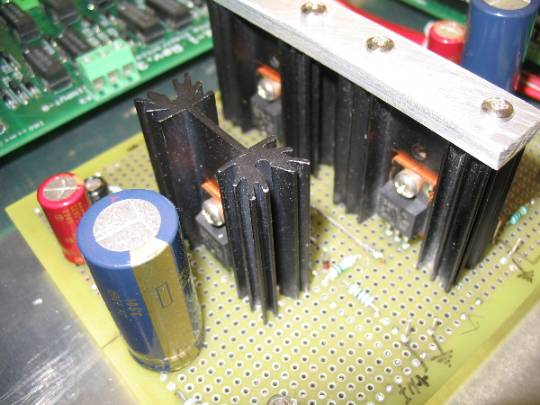

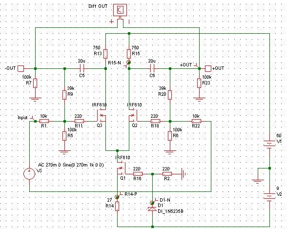

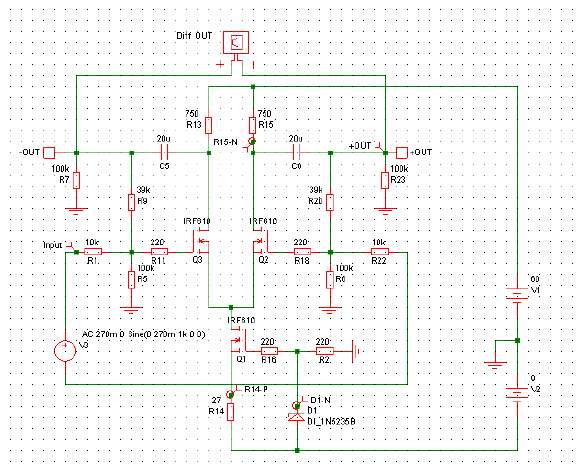

rebojorge,
The Schema - tic, in better definition,
Power supply +60 volts and -9 volts
{-9 volts adjustable by a LM317 in the separated Power supply}
The bias is set for 2*40 Milli amps and can reach 2*50 Milli amps
The zenner 1N5235 is a 6.8 volt 1/2 watt and the beauty is I only use of IRF 610's
All chassis are done by hand with a good file... All T6061 Aluminium
thickness: sides 3.2 mm back 4 mm, face 10 mm, foots are 3/4" round
my only "tool" is a Drilling machine... it works also as a "milling machine"
I'll send more if you like...
Hope to "power-on" next week!
Regards.
Alain.

Really nice work Alain! I have been tossing around the idea of doing something similar to your effort, but I haven't got any further than doing some circuit modeling in Spice. To see how ridiculous I could get, I built a model for a CCS-X-CC-BOSOZ ... or in other words, a constant current source supersymmetric cascoded bride of son of zen. I'll try to get around to posting my schematic sometime in the near future.

A good file, a lot of time, and ideas from all equipments I have seen.

Looking forward for your design ; or your SIMetrix schematic...
Thanks to all for the good comments ; I don't want to compete with any one. I am just trying to make a good setup ; and it's easy with all the ideas floating around the Passlabs forum. I have to say that if I can make an other version it would be different....
