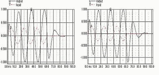

By the way, I just came across this chart which shows the difference between a box containing the Peerless 832732 woofer in a ported box and a Passive Radiator box. Note the difference in the fourth impulse. Ported is on the left, Passive Radiator on the right. Input is in the faint red line.
There is a definite difference.
