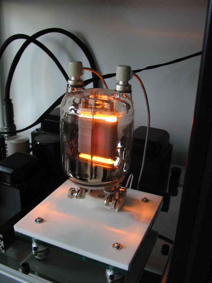

Hello ,
i finished my 833-amp half a year ago. so i needed these triodes as well.
I bought:
- GU-48 form Russia. $ 65 a piece
- Amperex 833A. € 100 a piece
- Penta 833C. $ 96 a piece
- Tungsram OT400. € 82.50 a piece
I don't know what you're looking for. There is a lot of difference between the items. Not only sound-wise, but certainly build quality !
And of course you have to take into consideration the postage to Canada.
Audio-wise:
- The GU-48. Bass-performer. Not very smooth in the highs !. Incredible sturdy built. Pins will not fit correct to standard Johnson sockets.
- Amperex 833A. Solid perfomer. Well built. Very good sound-wise. Also on the frequency extremes.
- Penta 833C. A tad more bass and a bit less in the highs than the amperex. Not better or worse......just different. Extremely fragile ! Yes, they can take a hammering in a circuit with the very respectable plate dissipation. But on transport.......
- Tungsram OT400. Same as the Amperex and the Westinghouse and the RCA i have already at my home. Pricewise unbeatable.
You need 4 x 833 ? Push-pull ?
Happy building.
Reinout

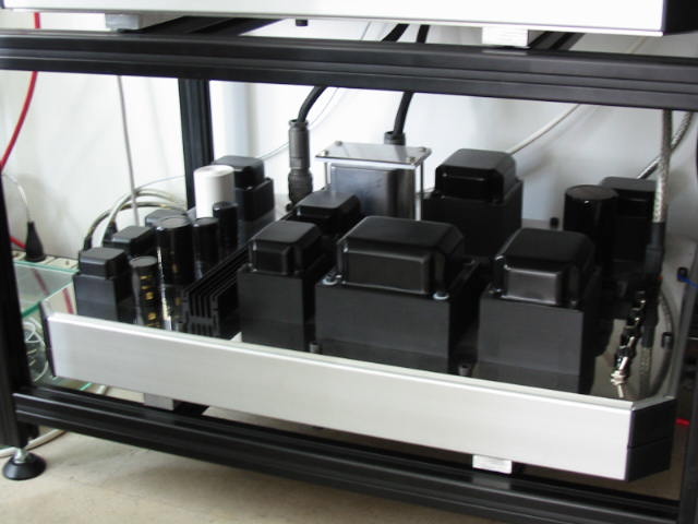

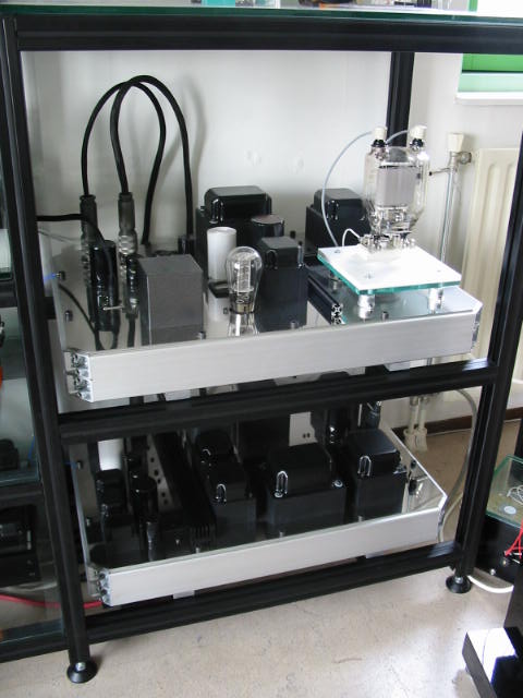

(included a picture of one channel 833-amp (up) with external powersupply (down)

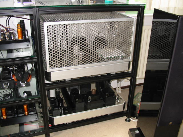

Oh yeah, I remember you. You're the guy with the unprotected lethal shock hazard in his listening room!
ReinoutdV said:Hello ,
<snippo>
Reinout
Reinout,
unprotected ?
Hello RCAVictim,
unprotected ?

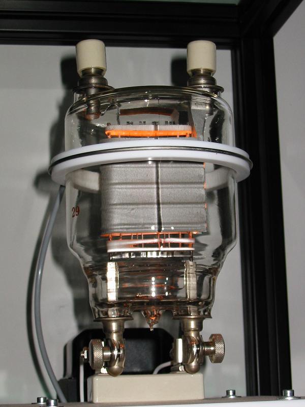

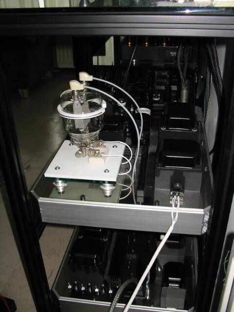

Normally i use the amps without the add-on cover. But when friends arrive that do NOT know that a tube can be hot-and-dangerous i'll put the covers on.
Same when there are children around. The holes in the cover are large enough to let the heat out, but small enough to withstand poking fingers......
But yes....i'm into tubes and these 833's are normally unprotected.
What kind of tubes/amps are you using ?
Reinout

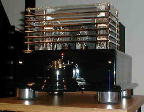

Re: unprotected ?
I've got two darling house cats (children) so I have to be careful not to have anything potentially dangerous out in the open even if I'm right there. My amp in the system upstairs currently is a pair of HF-20 Eicos (P-P 6L6's) with some DIY mods. Those are perfectly safe with no top cages/covers IMO as there are no tube plate caps or exposed circuits at all.
Downstairs on my more serious system I have a MC3008AB Ming-Da which has been extensively modified by myself. It uses 300B's to cathode drive 805's in SET. Part of my mods was to make the tube cover well interlocked so the amp cannot function with the tube cage off. I know that I will die someday, probably before I have a conversation with whoever gets this fine amplifier and I won't be able to explain the hazards. It has as much as ~1600 VDC on the plate caps of the 805's during the 30 second startup phase. Once operating the voltage drops to a still a very lethal 1050 volts. There is a lot of energy stored in the HV power supply in this amp. I dread the day a spider gets in there and causes an explosion.
You just cannot afford to take any chances with power like this....period.
What kind of speaker is that you have in the picture. Looks like a very nice piano finish. I worked hard to get that on my 805 amp. 18 coats of hand rubbed lacquer between every coat!

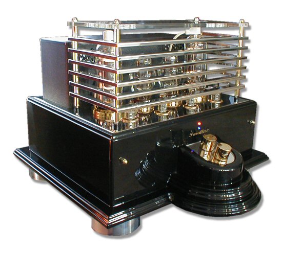

Hello again RCAvictim,
congratulations on your 805-amp. If it only sounds 1/10 of how it looks......you've kot a killer amp.
You're right about the safety features. You can not mess with these voltages. And currents: a 833 will gobble 20 amps during start up. Now that is something to take into consideration when doing your filament-wires......
I have to switch on 4 transformers in order to get "sound". The first is the powerline for filaments 6SN7/300B, the second is the powerline for B+ 6SN7/300B, third is the filament 833 and the fourth B+ 833. It is pretty straightforward but i did not want to use relais for they are prone to "stick". And that's not what you want with these amperes...
The speakers were former Monitor Audio Studio 50. 12 layers of piano laquer.....
Again congratulations with the 805 amp. Try that to buy in a store !

ReinoutdV said:Hello again RCAvictim,
With regards,
Reinout
Reinout,
Thanx for the compliments on my work. I went with two SS relays and low voltage DC control so I could get AC completely off the power supply toggle switch and Hi-B+ standby switch that shares the same copper shielded control enclosure as the low level audio volume control pots and source selector switch wiring. This amp, unlike as originally from the Ming-Da factory, along with many other improvements now has a choke input HV power supply and a separate 300 mA plate xfmer from Hammond. The HV regulation from idle to full power, 40 watts/channel, both channels driven is 0.1%. The amp has been in use now for about 6 months used several hours daily. I love it!
You are right about the high filament current issues, especially on turn-on surge.
Here is another view of my new 805 amp. I had bought this and done the modification as a prototype for an intended manufacturing run. I was planning to offer this item as you see it for sale. You're right, nothing quite like this in stores. Moth Audio has a 304TL monobloc that I'd compare this to I think.
GU-48 picture
Hi again RCAVictim,
here's a picture of the GU-48 in full flight. Those 833's do double as a nice room heating system.......
As for your amp: priceless. One-of-a-kind. And yes.....Moth is into that retro-style. I think an interior designer could live with your amp. As for my amp: it has a "mechanical" style. No frills, just purpose. No design marks for me; which does NOT say it is not very well build. On the contrary !
About prices: did you check out the new Wavac SH-833 ? At $ 350.000 a SE 833-amp with external powersupply and external isolation transformer. In the Stereophile july issue there was a test with these heavyweights (288 Kg per channel). OK, mine are just 140 Kg per channel and lack the CNC-milled casing. But my powersupply is just as good. And the picture of the innards of the SH-833 were EXTREMELY dissapointing. Simply ****-resistors. Not even audiophile ones. For $ 350.000 is expect nothing but the best.
Oh.......my amps were nowere near the 350.000 mark. Not even close. Not cheap (surprise, surprise with 32 transformers) but a somewhat different price-region.
How many are they planning to sell ?
Keep up the audio-work. My current projects are a new pre-amp and a DAC. Both projects are underway.
Reinout
Hi again RCAVictim,
Reinout
Re: GU-48 picture
Great picture. I didn't know what a GU48 was. Pretty close copy to an 833A. If you are operating your plates that hot I'd suggest taking heed of what RCA suggests in theiir transmitting tube manual for the 833A. Airflow should be directed downwards into the space between the plate and grid terminals to keep the seals from failing from excess heat. The max continuous dissipation with convection cooling is CCS 300 watts, ICAS 350 watts. With forced cooling CCS 400 watts, ICAS 450 watts.
CCS= Continuous Commercial Service. ICAS = Intermittent Commercial and Amateur Service.
