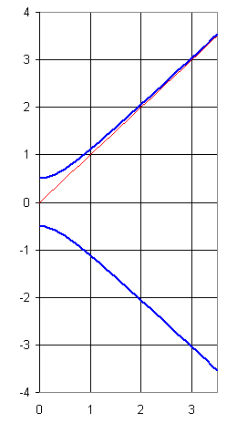

Waveguide profiles
Using an Excel worksheet, I've developed a routine to plot a profile. Variables include theta and "a", the waveguide throat. I had to go through some gyrations with page set-up, etc. to get it to scale. You should check this on your equipment. The depicted profile is for theta=45 and throat radius of 0.5"
I'll be glad to share this by e-mail.

"The pic shows an oblate spheroid is mostly like a straight cone that goes to zero diameter at the back side"
After a ton of reading Earl's posts in the archives of diyspeakers.net and the High Efficiency Asylum, I see what's been confusing me about the shape.
Most of the waveguide is a cone. The OS only describes the transition section from the throat to the cone, which while small is crucial to minimizing the amount of HOM.
@Ed: Excell is your friend. Just plot up the variables and you'll see fairly quickly where the apperture difraction limit comes in. I was just too lazy to solve it analytically so I drew up tables instead. Unfortunately that sheet is now gone.
