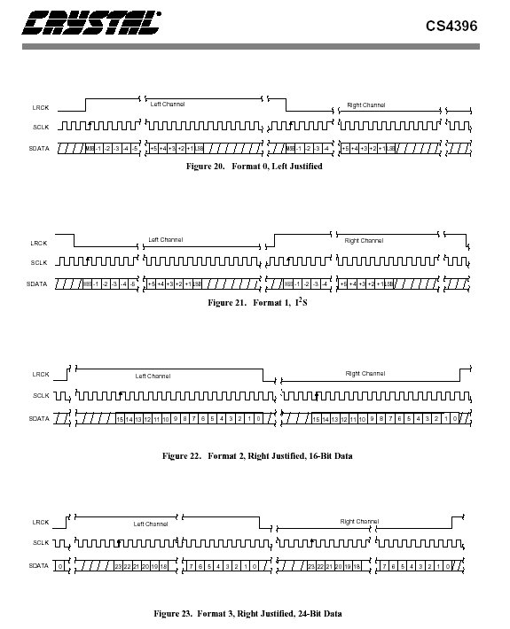

Read a datasheet for pretty much any of TI's dac's and they have the waveforms there. The one you show is Left-justified or as TI calls it "Standard format". I2S updates the data bits one clock cycle after LRCK changes.
Here's a picture.

It seems to me that the only difference between i2s and left justified is that the word clock is inverted with left justified in respect to i2s.
