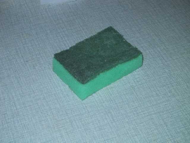

Your piece of alu must be washed with a solution of NaOH
dissolved in water. I have used about 3 good spoonfull's
for 2 cups of water.(NaOH= Caustic soda). It is done in much the same way as when sanding, only I use a Regular kitchen sponge
for the job. The rough green side of it . Just soak it often, as you stroke back and forth. Keep stroking for about 5 minutes.

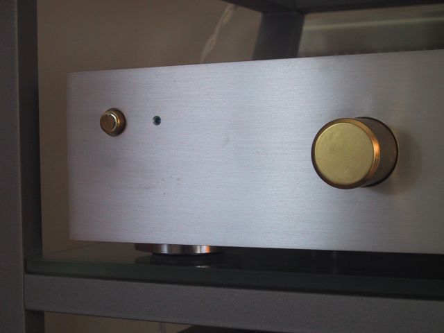

I attached a pic of my stereo, the preamp (BosoZ) is fitted with a faceplate made in this manner. It is about a year old now and looks like the day it was made.

I took some closeup pic's of the surface as it looks after
having had this treatment. The "Spongeway" is used
because you can make just a small amount of the solution.
This is more environmentally friendly.
Steen.

Bill, what you see is my greasy fingers on the panel,
The small black spots are imperfections on the material.
Meaning that I was not persistent enough when sanding:cannotbe:
Devil, the surface is etched by the process and it is easy to
keep clean. Fingerprints doesnt attack the surface. Mine is
about a year old now and there is no trace of tarnish or
miscoloration. In all cases, the surface is far better than
raw alu. I think it is a great alternativ to doing nothing
about the surface. If you dont get it anodized for real, that is.
After all, this is DIY isn't it ;)
Steen.

Bill Fitzpatrick said:
what is the source of those flaws on the panel?
steenoe said:
Bill, what you see is my greasy fingers on the panel.
Meaning that I was not persistent enough when sanding.
Steen.
