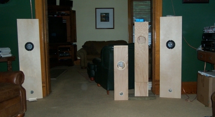

abpea said:There was one weakness everyone agreed on. These speakers (and maybe all FRs in general) are superb listening to acoustic, female/male voice, piano/jazz type of music. But they let you down big time listening to loud hard rock/metal music.
Does this apply to the smaller 31" line and the trapezoidal line too. Since you have built all 3 lines which of these would sound best in an HT/AV enviroment. I am hoping to use the same system for HT/AV as well as audio.
I feel the box in the center of the "group shot" or the smaller on on it's left would have the best WAF.
Re: Re: New 48" ML-TL Review
Hello navin,
Yes, same applies to all of the different versions. I think if you want a really big bottom end you're going to end up using a sub in your system for rock music, etc. On the other hand as I mentioned, if you mainly listen to accoustial, live, jazz type of music these speakers will delight you to no end.
The smaller cabinet in the picture is the trapezoidal version. I actually was playing with different ways of mounting that speaker in our tv room to use in our HT setup. And you are right, the smaller one (trapezoidal) has a large WAF. My wife didn't object when we discussed mounting the 'traps' on the wall!!
Bruce
Hello navin,
Bruce

abpea said:Yes, same applies to all of the different versions. I think if you want a really big bottom end you're going to end up using a sub.
Bruce

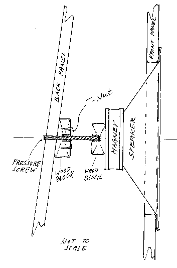

Driver Brace
This link previously mentioned: http://melhuish.org/audio/images/press-screw.gif
no longer has this detail. Doe anyone know the how the brace is made? I have read GM's recommendation to include this brace in the construction. Also is felt recommended behind the driver in the trapezoidal and the triangular arrangements, if so, which walls? Thanks

artus said:This link previously mentioned: http://melhuish.org/audio/images/press-screw.gif
See attached. Theoretically the trapezoidal one will need some on the parallel flat back panel and none for the triangular, but as always, best to do your own listening tests. FWIW, I've found that lining the back and one side of the trapezoidal and one side of the triangular has the best balance of damping/acoustic gain.
