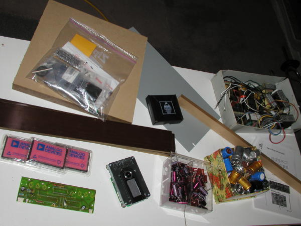

Since I finished my Aleph 5 and it's pretty good I thought I might start the construction of a CD transport based on Philips CD Pro 2 mechanism, before I devote my efforts to finishing the GAX (whoever red Aleph-X thread will know what I'm talking about). For more info check the thread http://www.diyaudio.com/forums/showthread.php?s=&threadid=3243&highlight=CDpro
I want to built my unit with rigid suspention and separate power supply. For proper perspective check 47 Laboratory site http://www.sakurasystems.com/products/47transport.html
Eventually I will add no oversampling DAC through I2S based on 6 AD1865 chips. Since I didn't get much feedback in my other thread concerning regulators for digital circuits I will try LT1085 chips and maybe upgrade later. This is all I need for my transport. Check this site often because in response to some e-mails I will be posting more pics as the project developes. I estimate two weeks to complete.😉

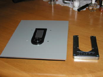

I modified the mechanism frame to accomplish rigid mounting. The original top base was removed, and new, much bigger base was made out of 3/16" aluminum. I thought of thicker material, but then, picking out the CD would be more difficult. That base will be mounted on a platform made of a composite material with a cutout for the mechanism. There won't be any cover on top or a CD compartment.
One might think that CD compartment with door will somehow isolate CD from external vibrations. After reading review of YBA player in FEB 97 issue of Stereophile I came to different conclusion. They made comparison and used the same player without top cover and both Yves-Bernard (the man behind YBA gear) and Jonathan Scull (whose opinion I value a lot) agreed it sounded better without cover. I can only suspect that vibrations created inside the CD compartment are worse that the ones coming from the outside.

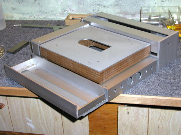

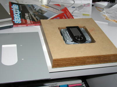

I carved out the base for the transport (or should I say core?). It's made of some kind of composite material I bought surplus and is quite heavy. I compared that material, as a platform for turntable, with MDF, granite and aluminum and it always sounded better. So I figured out it might be good material for my purpose. The other choice I was considering was glued 3/4" maple plank. But the weight would be less, maybe a drawback in that case.
Top plate, or platform supporting transport would be installed to it, as well as front panel containing display, rear panel with all jacks and side panels made of another composite. The additional circuitry would be attached at the bottom without bottom cover.

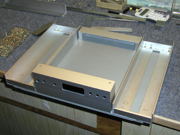

Progress report
Do I love to work with aluminum. 😉
Chassis slowly coming to a shape. I decided to do everything with separate modules to avoid complicated resonance modes. Front control panel, back panel for connections, both sides: power supplies. In the center a space for transport platform suspended by 3 spikes. The platform is not connected with anything else. 1/4" bottom plate will be resing on 1.5" composite platform.
