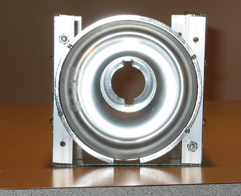

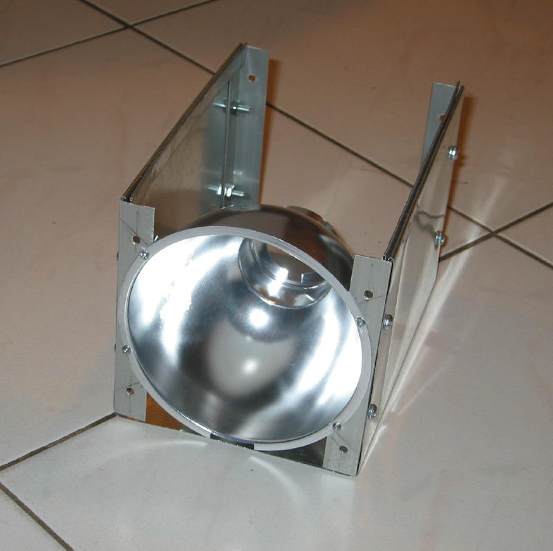

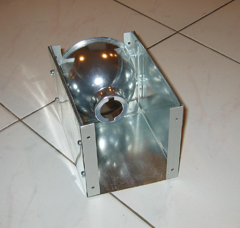

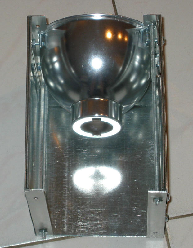

here is a few pictures of the light box (not finished yet):

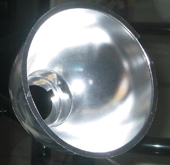

This is the reflector I am using... bought from home depot.
Do you guys thing the surface is ok? Do I need to stick some aluminium duct tape on the inner surface? I am worry about the heat. 5 minutes after I turned on the light, the reflector is hot. If the inner surface get hot, I am afraid the aluminium duct tape will get loose... will it?
heya buddy lets take a look at somthing, what can handle more heat? the duct tape or the metal reflector?
Dont go putting duct tape in there or you will have a fire, period, just leave the metal reflector the way it is, polish it if you want a better surface, duct tape is crap man and a fire hazzard. Dont go putting anything near that light that cant handle atleast 300 deg c.
