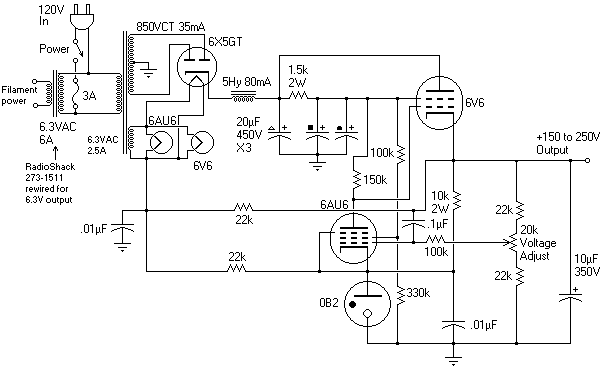

FWIW, here's a design I drew up a while ago. If you bump a few of the parts it can do any voltage range you wish.
Tim

Bah, tubes are sturdier than transistors. More than 20V across a MOSFET gate = plink... Too much voltage, dissipation or excessive negative base voltage on a bipolar, plink! (Addmittedly, bipolars are quite sturdy otherwise and will work fine here. Just don't touch the heat sink.) LM317's are useless as you lose the 40V input range quite easily over line variation and transformer regulation.

Fifteen years of experience with "exotic" tube stuff taught me one thing for sure:
First thing to die in a tube pre/amp is those fancy pancy sand regs, the ones you don't have a clue what the heck they are as these guys have of course their references wiped away and have to make a dozen phone calls for to find out what the heck they are etc., etc...
Not to mention the fact that they make your tube stuff sound like sand as well...could just as well have used semis in the first place...
Another advantage is that these tubed regs using those lovely VR tubes make for a nice slow start as well....Great, no?
Since we care about sound, why not use what is reportedly the best? A shunt reg....

Frank, Tim, I've been using various bipolar-based HV regs for about 20 years and have only lost devices through my own stupidity. If you understand how to protect and stabilize them (and certainly Curcio does), they've got lower source Z and lower noise than any tube-based reg I've ever tried. Solid state does better at DC, there's no way around it.

While I'm sure Mr. Joe Curcio understands how to design a fine SS regulator, there are other factors that to me at least are of importance in designing a regulator for audio use as well:
- Low Zout for a regulator is secondary to me for as long as the Zout is consistent throughout the frequency range we envisage of using.
If we consider the fact that series regs are Class B devices heavily depending on NFB and the response time of the error amp it becomes clear that any series reg will be relatively "slow" no matter what we do. This can become painfully obvious with loads operating in classes other than Class A but I digress.
- Noise, no big deal: VR tubes are often quieter than common Zener diodes and far more reliable in operation too. Whatever noise is left it's far less obtrusive than Zener pops and crackles and when operated and filtered correctly the VR tube will be rocksteady noisewise.
- Solid state does better at DC. Fine by me but that hasn't convinced me in view of a tube load attached to it which opearates quite likely in Class A at about 30mA anyway.
- With a tubed regulator, provided it's wired correctly, you can remove the load: no problem.
You can pull the series pass device: no DC pass, no problem.
You can pull the error amp or VR, ditto.
- Despite my stupidity, I never had a single tube regulator die on me yet, ever.😀
-There's a host of things you can do with what at first looks just like a regulator, or at least I know what you can do with them by using my tubes whereas I'm not certain at all I could achieve the same with semi-conductors...the latter you can easily chalk up to my ignorance in that field of course.

Frank, the reference voltage source is, of course, one of the keys to low noise, stable regulation. Different methods have different virtues. One advantage of the zener string is that it can be bypassed more heavily than a VR tube. A disadvantage is that the voltage coefficient with temperature is not so good. But that's less important for a preamp stage- it's not as important that the rail be 245 versus 250 volts, but it is certainly important that the noise be low.
The two versions I use of Curcio's regulators have two different means of generating the reference. The older ones use a FET configured as an adjustable current source. The CS pulls voltage across a rather large resistor to generate the reference voltage. The newer ones use a bipolar/317 combo to generate that voltage directly. In each case, a FET-input opamp can look at the reference voltage through a decently sized RC filter. That also slows the startup.
The output of the regulator is stabilized quite nicely by a good-sized output cap (seried with a small resistor). The result can easily be seen with a scope probe while playing music through the powered circuit- thatis, you don't see much other than DC. I haven't seen (or heard) any ill effect from this sort-of class B operation. The regulator does what it's supposed to do, provide a stiff, low-noise rail that well decouples each stage from the others.
