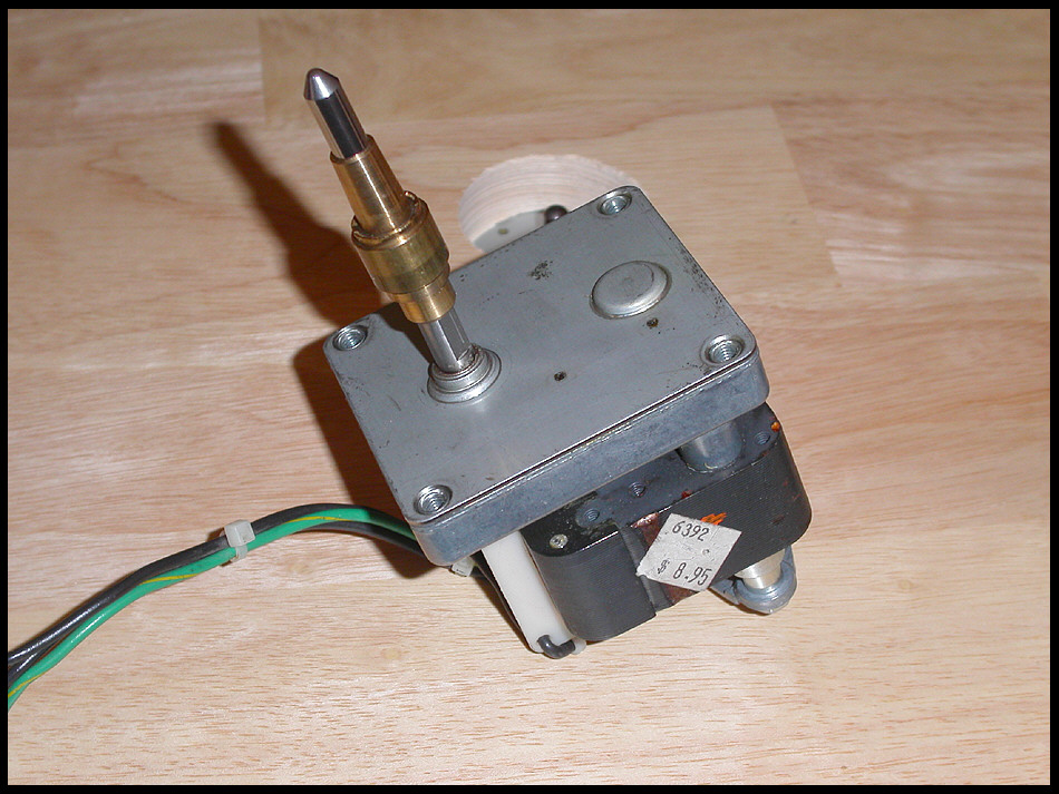

The AC motor above was too fast, and I could not slow it down... I found the perfect motor on ebay:
http://cgi.ebay.com/ws/eBayISAPI.dll?ViewItem&item=3836299951
http://stores.ebay.com/DC-Geared-Motors_W0QQsspagenameZl2QQtZkm
Got it installed, turns at a perfect 10rpm at 12 volts and has a huge amount of torque.
All done!
