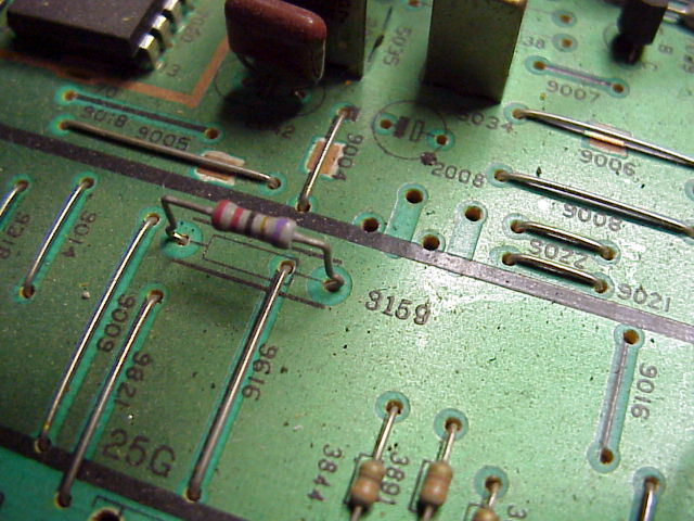

My beloved 66SE ki amp has stopped working, the indicator diodes go on but there's no audio output from either speaker outputs or headphone socket.
I'm handy with an iron but have never used a multimeter although I'd be prepared to have a go if I had a pointer.
Any chance anyone could point me in the right direction? Do I need schematics for example?

My PM-66SE has just developed the same problem...
Power light is on, but no output from speakers etc... Its also missing the "clunk" sound it used to make shortly after power on...

I would guess R802 and R807 are resistors on the board. No idea what "47R" is though!

If the components numbers are not marked on the PCB, you'll need a schematic.
I don't have it 😉
If they are, look for resistor R802 or/and R807 which is (are) 47ohm. They could be broken.
Here's another tip if you have no access to docs:
Check for resistors lifted from the PCB like on the picture.
Measure the voltage on both sides with respect to ground. If you have for example 12V on one side and nothing or very little on the other side you know its broken. Measure these type of safety resistors with an ohm meter. Make sure you turned the amp off before ohm measurements.

Sorry i missed the question: Did it work out. In my case it was the 802 resistor. It is located close to the rectifier bridge and the main caps. If you have the big elcaps to the right of the rectifier bridge the resistor is directly below. It is connected (via pcb and jumper) to the collector (middle leg) of the transistor located close by.

The result if it is broken is that you are missing the +24V feed, i think there is some markings on the board indcating which one it is.
It seems this resistor is meant to work as a fuse?

Thanks guys I fixed my PM66SE KI
Thanks a lot to all those who suggested R802. My PM66SE KI has been gathering dust (No output but lights come on). No one could help me with the schematics so I could not do a thing.
Today I measured R802 after reading the suggestions given and the resistor had blown. I managed to get it sorted with a 5p resistor within 5 minutes (I just cut the blown one with some cutters and soldered a new one on top without opening the base). Its up and running now.
