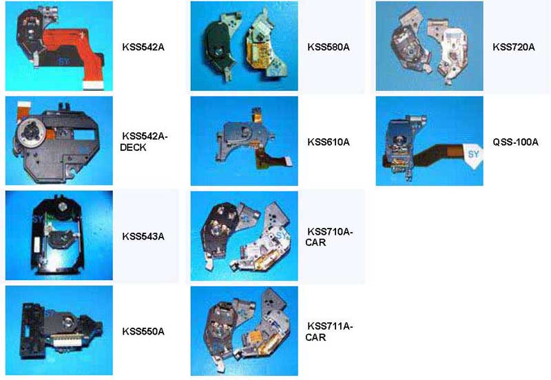

Thanks deskmate88
Impressive and a good reference too.
I didn't know there were so much.
As for which one is the best, no idea.
Picture don't show up is a forums behavior to save bandwidth.
Unless you host them on another server and link to them.
/Hugo 🙂
