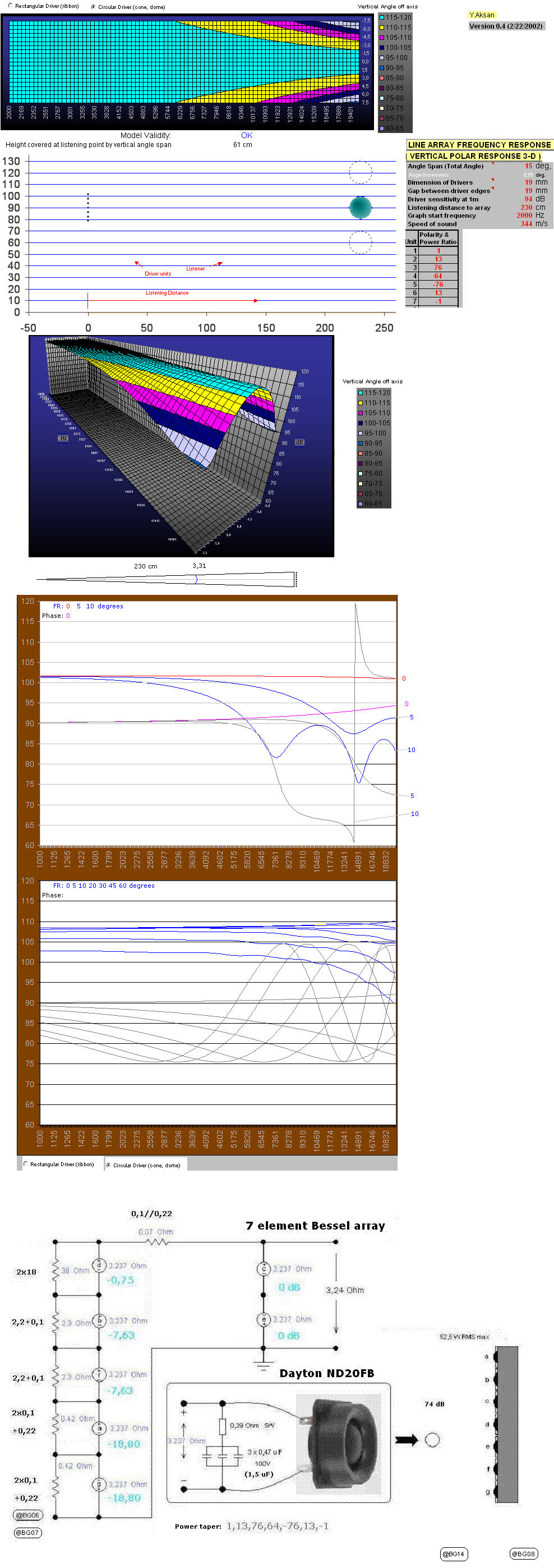

Going from memory it was +1,+2,-2,0,+2,+2,-1 for the 7 unit array and +1,-2,+2,+2,-1 for the 5 unit array. The "-" amplitudes are accomplished by wiring the driver out of phase. I wired the 2's in parallel and the 1's in series to allocate the power accordingly. I think the 5x5 is 1st row the same as the first column, so the minuses run diagonal.

In my post above, I made a mistake. The 5 driver bessel has no -1, otherwise it is correct, but just one of the 2 pwer factor drivers is wired out of phase.

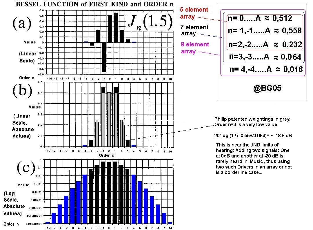

Hello!!
Can somebody help me, please! I write the article about Bessel Arrays, so I wonder where were the weighting factors taken? So how can we get them? From Bessel function? Can somebody explain please!
And why n=1 is always taken, why, for example, not n=2, 3,....
Thank you for your answers!

From the Philips paper it appears that n=1 is the easiest to implement.
Attached the Philips paper, the patent is here:
Patent US20060018490 - Bessel array - Google Patents

You will probably find answers here:
http://www.xlrtechs.com/dbkeele.com/PDF/Keele (1990-10 AES Published) - Bessel Arrays.pdf

I've seen all this papers and patents! But they didn't answer my questions!
I found the directional characteristics of 5, 7 and 9 elements for n=1 and for n=2 and 3. And for n=3 the directional characteristics are better than for n=1. And now I wonder how were all the weighting factors taken? I'm interested in acoustics or maths way. In all these papers they just say that's better. But why so??
FYI:An example of an T-array that when listened to performed very similar to an Scan-speak D2905-97000 timbre-wise at a distance of more than 1.5 m.
