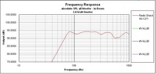

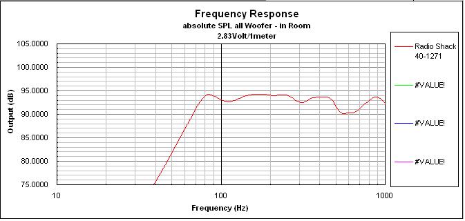

Hi GM,
I have done a lot of reading and tried out that spreadsheet. I just pruchased a 2050 radio shack SPL meter on eBay, so I am looking forward to using it when it arrives.
From the spreadsheet, I got about +/- 4dB with dimensions of:
Baffle Hight (mm) 900
Baffle Width (mm) 350
Hight above floor (mm) 900
Dist. rear Wall (mm) 100
Dist. side Wall (mm) 300
You mentioned your baffle was about 34" (860 mm) across. What height did you use?
Would adding a small cheep tweeter such as the onyoko buyout crossed over at bout 4k help out the high end reasonably?
Do you have any pictures of you 1271 in an open baffle?
GM.

baffle sizing
Tapered! Now you are scaring me. I dunno if I messed somthing up in my calculations. I have attached the frequency response I calculated using these dimensions:
It looks reasonable to me considering they are $5CDN drivers. If it wasn't for that dip between about 500 and 800 Hz, I would think it is pretty nice. Have I missed something?
The dimensions of 900X350mm is something that I could work into a room.
Why?! It just averages out the baffle step for a more gradual transition from half to full space.
Baffle Hight (mm) 900/35.43"
Baffle Width (mm) 350/13.78"
Hight above floor (mm) 900/35.43"
Dist. rear Wall (mm) 100/3.94"
Dist. side Wall (mm) 300/11.81"
Hmm, baffle height and driver height the same, with half the driver hanging off? Not a good plan. Baffle width is OK considering its proximity to the wall/corner, but the dip out around 500Hz makes no sense to me since the driver is already radiating in half space, so from ~539Hz - up will be narrowing with increasing frequency.
My baffle was for placement out into the room a bit, so not suitable for a near wall/corner placement. Still, tapering it should help with smoothing out the dip somewhat down near Fb.
GM
