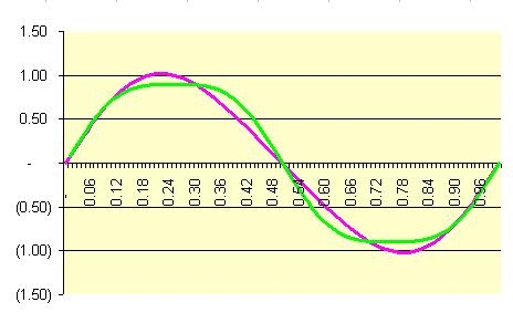

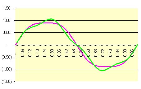

along the same line from tiroth's pictures, I put two more together. Each trace in a picture has exactly the same amount of THD (10% in this case). And you tell me which ones you would like to hear (like "pink in picture 1", or "green in picture 2").
here is picture 1.
here is picture 1.

millwood said:along the same line from tiroth's pictures, I put two more together.
Picture 1.
