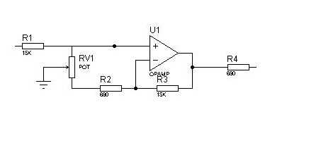

I've built a few preamps with a pot in the feedback loop of an inverting opamp. The pot used to become noising after a few months but I realised one day that I hadn't bothered to add a input capacitor. Once I added the input capcitor and used a fet opamp everything has been OK (so far)
I've also seen a nice non inverting circuit in electronics world december 1995 pg 1012. This uses a 10klin pot. The advantange of this circuit is that the opamp gain is very low when the signal is reduced to 0. See attached
Mark
