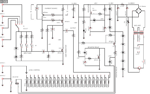

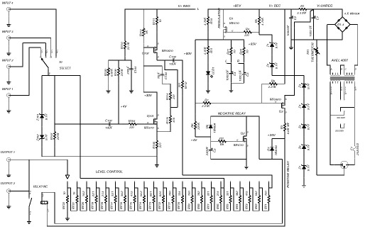

A lot of people seam to be reading this post, yet nobody has an opinion. Maybe it would help if I posted small pics right out of the PDF to inspirer people to have a look.

LBHajdu said:
Does anyone know what inspired the new topology and what the sonic differences are to the older always active version?
Hi LBHajdu,
As it is common knowledge NP is a follower to Albert Einstein
"As simple as possible....."
You simply don´t need active circuitry at a gain below zero.
Therefore not even one active (polecreating) device is in the
signal path anymore!
Something that isn´t there cannot colour the sound!
Uli
:nod: :nod: :nod:
Well there may be nothing in the signal path, however the gate of the first input mosfet will load it with a little capacitants. Some source outputs don’t have the current to run passive. I wonder why this design was never used in any other pre-amps opting instead for always active circuits. I can,t even tell if its really passive below the 6th to last contact.

I built both versions some 2 years ago.
As I remember I liked first version (all time active) much better.
And indeed Aleph L is excellent preamp , especially considering number of parts used.Aleph P 1.7 sounds better still but I can see it is pretty much balanced version of Aleph L with added negative CCS.

I'm not that wizz at knowing these topologies.It seems to me that untill some point second version works purely as an passive attenuator.If this is true I don't see the point of using it as in my expirence active preamp always sounds better than passive (especially driving Alephs).
There might be enough gain but there are other factors that make passive attenuators sound worst than good active circuit.

I agree with zygibajt.
I have built both versions of Aleph L and I think the original version sounds livelier, more dynamic with more control in LF and with more presence in the midband.
The only "drawback" is that it is phase inverting at the output but then I don't think it is actually a drawback.

Ive been looking att the scematics (v1.2) and can´t understand how the input impedance can be 20Kohm..
Anybody care to explain?
And how do I calculate the output impedance? Looks to me like it schould be wery high?
If this were my design I would add a buffer-stage to the output..
