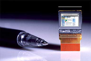

SVGA micro-panel below $$$

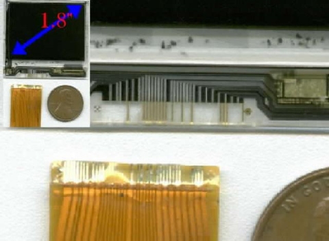

LCD-Ribbon Cable Repair
I posted this in the "DIY projector" thread also:
Is there a known way to repair ribbon cables that have been torn off of the glass substrate of a panel?
This is a higher res screen (520x240) that I would like to use again. You can see the leads on the glass after the ribbons' area are still intact. Is there some way the ribbon can be reconnected?
If it were a larger cable I could do some micro-soldering. But, with
this one it would have to be nano-soldering!
Some sort of glue & heat process in the factory, originally, I guess.
I hate to toss it. And the picture was enjoyable to watch.
Anyone with the in's and out's of it?
Any advice welcomed!

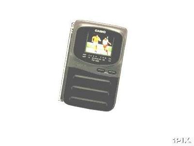

WEll I finally got the little TV I was looking for....
It's a CASIO model TV100-B which has surprisingly good color for a crappy little LCD TV.
The screen is about the same size as an actual slide...so if I can figure out how to take it apart and perhaps improve the tuner and add some sort of input...I may have it working by the end of the month!
Hey MannyE!
Welcome!
Here's some data put up on Ebay on your tv:
TV-100 1.6" High Quality Matrix Passive (HQM) Pixel Count: 39,600 Reception: UHF/CH14-CH69, VHF/CH2-CH13 Features: AC Input. Earphone Jack, Rod Antenna
Not sure what the "B" stood for. Maybe no different. You have a slide projector, right? Okay, ~240x160 pixels.....Well, you can still have a little fun with it! Passive isn't as desirable as Active is and the res is on the low side, but what the heck, you have the "stuff". Why not make one!
I didn't use this one before. But, I imagine it's not too different from the Radio Shack PocketVision 32, I used.
Basically, open it up. You'll probably need jewelers screwdrivers as most of the screws are tiny phillips type. Just, do everything slowly!! Especially when near the screen. Which is pretty much always, at this size.
Some things are in place by screws and some by pressure retainers, including the case itself. You'll have to probe around cautiously. Never force unless you know it's a pressure retainer(only) for sure. Sometimes you'll miss a screw and then "poof!" pieces everywhere, circuit boards cracked, doohH!
If you're not sure of how to get the backlight off, take a pic and post or send it. I can also show you pics of my Shack one I still have either way. Mine might even be made by Casio too! Mine had an opaque white backing that was simply glued on and a light tucked nearby.
Also, you can hook up a picture through the tuner tuned to channel 3 and taking a RCA banana jack (other end in the vid out of your vcr-make sure a tapes playing or something on the vcr tuner) and sticking either the center of the jack or connecting the outside part to where the antenna is bolted to the board and the other part of the jack connected to ground on the board. Gotta meter?
The tv is auto tuned so you'll have to keep pressing the 2 buttons back and forth till you get the picture in (don't forget you might have to reverse the connections running to the RCA plug). And, maybe you can try it out before opening it up, by contacting the RCA "banana" jack to it. Forgot if its the center or outside. But, it's not sensitive to damage, so don't worry bout that. Use alligator clips if you've got em. Just press the tuning buttons back and forth as it goes by the channel 3 area. Then when you figure which line is the hot side you can solder something to it later when you want to start projecting movies.
Well, I'll leave you with that. Post if in doubt.

I have not yet disassembled the Displaytech device but I do know from studying the specs that the LEDs do not require any modulation.
They have provided LED driver pads, so the only special thing the end user does is load 3 sets of registers with some values that will enable LED current adjustment to achieve a reasonable white color balance with the 3 colors.
So actually, it is a tune your own color with your own LED combo kind of setup.
