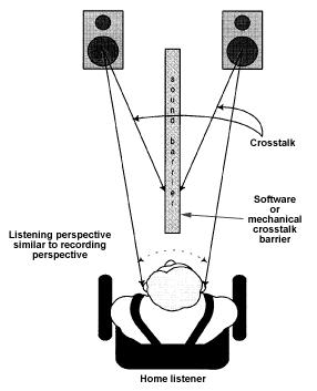

Have anyone here tried Ambiophonics? http://www.ambiophonics.org I think this is the way to go if you want to experience the 'you are there' illusion. I strongly suggest you to try out a simple experiment: place your speakers in front of you in 10-15 degrees angle and put an absorptive baffle (e.g. a mattress) between the speakers almost touching your nose (see the pic). For the starters don't care if you don't have the reverb channels, as in real Ambiophonics.
Warning! You will be amazed! After this it is hard to go back to the usual 60 degrees stereo triangle.

This method works properly when you are reproducing a recording intended for this application. In other words, the microphones must have been placed to capture the source material as if though they were ears on a head.
I've made recordings like this. It is more realistic, but it is much more suited for ambient recordings, e.g., city noise, sounds of nature, and whatnot. However, traditional soundstaging of musical performance (except maybe symphonic, but even then...), in my opinion, is best reproduced in the way we've become familiar. Besides, can you imagine providing a listening environment of this nature for more than one person?

I've been listening like this for years now. I could never go back to a 60o triangle again. I find it somewhat interesting that I've mentioned this to my audiophile friends and many have opinions, but none have ever actually tried it! It only takes about 5 mins, move your speakers together and stick a barrier down the middle. If you don't like it, fine, at least you tried.

I gave it a go, was very interested in it, but unfortunately I didn't notice anything special....am actually quite disappointed about it.
At least there is a very simple way to give it a try, especially for me as my computer skills are very limited indeed.
trouble is, the barrier method is so 'foolproof' that for the life of me I can't think of anything that I could have done wrong :sad:
When have a bit more time I'll try again I suppose, but have no high hopes this time (which may be a good thing!)

It took a little time for me to get use to it. I was so used to the triangle setup. I had to switch back and forth over a period to unlearn the commonplace configuration. The main reason it sounds better to me is, my ears are more convinced there is live music in front of me now. This is especially true for width and depth. Every other system I listen to sounds like music on a flat pane with no 3d feeling. I am at point now where this is more pleasing than doing a million tweaks to to system components.

That was my experience as well. The phisical barrier occupies a lot of space and takes a while to get used to. And it is such an uncommon set-up that for a while you keep switching back until you realize that, yes, 60º sounds unreal and creates listening fatigue over extended periods. From then on you don´t look back.

When I wrote my little post earlier, I didn't mention it but it was in my mind as I typed, my physical barrier was very much jury-rigged, even to the extent that I physically held one end of it up whilst I leant forward close to it. Not very conducive to long term evaluation. To be honest though, the terms usually used to describe the difference -amazing, significant etc etc all the usual audio descriptions, (my favorite) veil lifted- seemed to indicate a night and day difference that that would not take long to find. Perhaps that is wrong and I'm curious enough to give it another go.
So, as a sort of survey, how many of you are (still) using physical barriers??
Fcserie I hope will get back to us about the dsp he uses. Fc, did you start off using a physical barrier and then move to DSP?? and if so, was the only reason one of convenience/appearance or whatever, or was there a significant sound difference/improvement as well??

I got the xtc cancellation to work for me from the ambiophnonic website. Mr. Glasgal and Miller were very helpful in emails helping me to configure it. I think the barrier sounds much better. There is probably some way to get to a point where the pc sounds better, but the barrier is so much easier cause I don't have to fight the pc with 4 soundcards in it. I also like not having a pc on.

instead of using an impractical physical barier one can try "Stereolith" or "Beveridge" positioning with nearly/equally impressive results (but "Stereolith" positioning is VERY recording/loudspeaker/room dependent)
