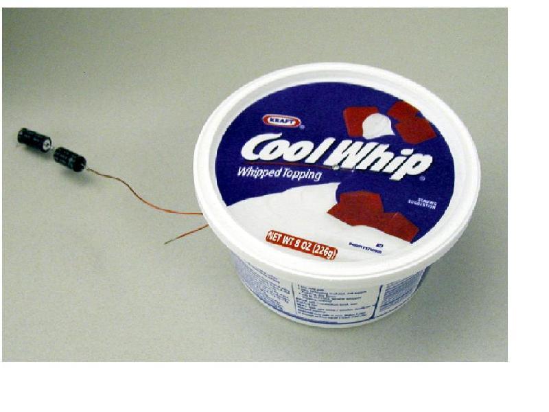

make your own driver.
Wow, your idea is alittle bit more complex than mine!
I was shooting at more of a grade school science fair project than a 'real' speaker; and it sounds like it! I get some intersting looks when people pass by my desk at work and the PC sound is coming from a cool whip tub.
Any ideas for a DIY tweeter? The high end is limited, can a paper 'whizzer' cone be added to help this?
pics
here's the outside of the speaker
