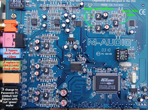

Modding the card a bit should get you astonishing improvements: replace the +/-12V smoothing caps (470uf/16V afaik) with 2200uf/16V low esr ones (take care when you buy to make sure they fit); replace opamps with OPA2134AU and you're good to go.
The opamps are directly fed from the PCI's +/-12 (yuck - garbage)so that's why you need to change the filter caps.
PS. practice (de)soldering ic's on an old piece of junk before getting to the card itself. I used a small pin to gently lift one foot at a time and a ordinary soldering station.

It's the same for the 410 or the Revo, for obvious reasons the layout is different...
I attach a pic for the Revo, shunting the front channels I/V filter output coupling caps is highly recommended (check front output offset). The mylar bypass i mentioned in the pic for the Pana FC is totally useless (read harshness) but changing the three opamps for the front channels brought the card to another level of detail. On mine I haven't changed all the opamps, just the three for the front channels (I/V & buffers); the pic is taken before the mods.
Make sure that the supply caps will fit, get smaller if not... take the cap datasheet and check that the diameter is <12mm or something like that. Any low esr cap will do, I have Rubycon ZL 3300/16V in now, downside is that the Rubycons are very long and the card eats the bottom two PCI slots.

Just to make sure I understand you. By shunting the output coupling capacitor, you mean short circuit them but making sure the offset on the output does not rise above 10mV?
The rest seems pretty straight forward. Find a large low esr capacitor for the main supply of the op-amp and replacing the op-amps.
If I have trouble finding an op-amp, what should I look for, low noise, high slew-rate good CMRR? I remember seeing the board being equipped with NE5532 which I thought was a pretty good op-amp.

For opamps OPA2134 - AU package or AD8620. First can be found for $3-4 the other is too expensive and not easily available.
Shunt the coupling capacitors=replace with a piece of wire (non-ferous resistance leads are great for this, or you might solder underneath the board to check). DC offset shouldn't be a problem but it's good to check at the output after mod.
OPA2134 - does not oscillate, does good with the +-12V power lines, DC offset without coupling caps is very low - 2mV and 3mV and the sq is just great. Not on par with the greatest CDP/DAC 🙂 but should beat the hell out of any mainstream CDP.
Regarding the circuit layout - the 410 uses a different chip/DAC/ADC than the Revo, I can't remember if the front out is buffered or not, but the same 5532s for analog - locate the AKM chip - DAC and see what opamps are near to know what to replace; 470ufs for +-12V filtering should be replaced too with something better.
