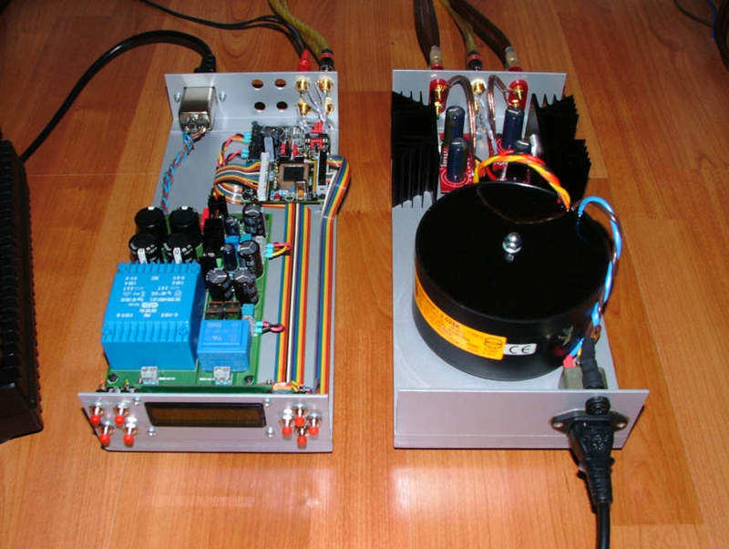

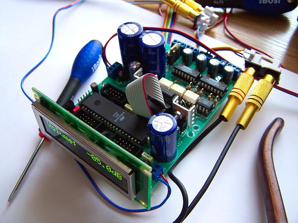

Some time ago I decided to build a pre-amp on new TI pga2310 chip (this one is theoretical better than cs3310 offered by Crystal). There was a few models and ideas of it, but the (maby) final version You can see od the pictures below 🙂
Pga2310 is controlled by Atmel ATMega chip via SPI transoptor-isoleted bus. There are two ways to controll the volume, mute, zcen... - rc5 ir pilot or Bourns digital encoder.
Few board was made for me and the Lukar forum, and they will be tested soon. Software for uP still need some improves, but it is working enough stable now 🙂
More infos (in Polish only) and pictures you can finde on my web page www.veteran.of.pl

Woo.. using a Crystalfontz PLED/OLED display (i work for them).

Hi veteran
Yours sure looks nice (AND compact)
Hopefully you find time to test them thoroughly soon (and post some results).
A few questions maybe :
I noticed you probably use 78/9xx style regulators for the analog supply. Can you measure what noise leeks through to the outputs ? Maybe a lower noise type could make a difference ?
And a more trivial thing : the specsheet says 10 mA quiescent current, but do you have an idea what would be the maximum current (probably at the +31.5 dB setting) into the 600 ohm load ?
You seem to have extra coolers on some of the regulators...
That would be a nice thing to know as I'm designing a similar one but with tl431 style regulators, which can't have that much current...
The 'woofer' is just the 2nd pga controller isn't it ?

->MWP
The sound is very neutral and op-amps inside the pga2310 works as a impedance buffer (with gain from -91.5 to 0dB).
->Alien8
I'm useing lm317/337 (+-15V) and I think that they are good enough for this aplication.
If you need more powerfull output use op-amp buffer. I don't recommend the 0 to +31.5dB scope. If you want to amplify the signal- use an external non inverting opamp (opa2604, opa1632...).
The second pga2310 is for a XLR but i'm useing it as a woofer driver.

Hi, actually I'm also workimg on a similar design. But in my preamp there will be a buffer before and after PGA2310. As a power supply there will by LM317 and 337 with TL431 as a reference. See in datasheets.

Hm... OPA548 is a good idea. I have few of them. The E/S pin is very interesting, but I have one problem. Will it be wrong if I disable + and -15 in PGA2310 and left digital +5??
Hm, I have no idea actually. I don't think anything will go wrong, the thing just won't work, but that's probably what you intend to make it do when you cut the power to it 😉.
->kafka
There wont be any problem if you leve +5V for digital section od pga2310.
If somebody would like to cut the power from pga2310 he can use a LM317/337 supply driven with a transistor (so you can controll it with TTL signals).

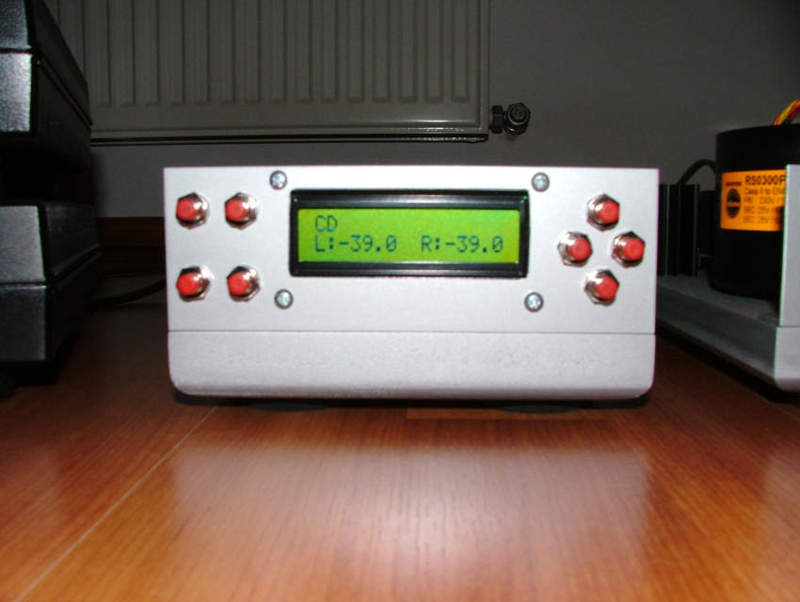

The NIGC is a basic kit from BrianGT. It's playing for about two weeks now and I must say that it sounds surprisingly good. The toroid is the most expensive item of the whole amplifier, so value for money taken in to acount not bad at all. The digital volume control sounds better than my passive preamp (blue Alps pot) but I still didn't had the opportunity to do some extensive listening.
Attached a pic with the front view of the thing.
Happy listening
Walter
Happy listening
Walter
