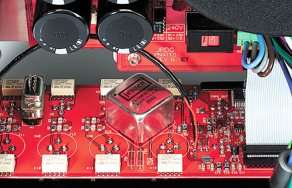

As for which one that JRDG uses............maybe you should look more closely.
Jocko.
It is Jensen in JRDG Concentra amp

Peter,
Check again. That transformer is to the pre-amp input or output of their integrated. You need to check the 211, 301 and 501 power amps.......... nice try though. 😉
Jam
P.S. Also the Concentra is a discontinued product.
