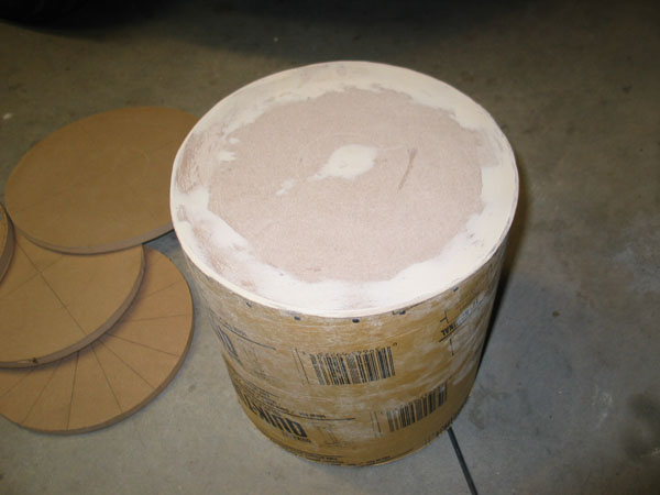

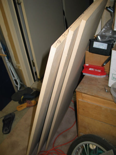

Ok, I got all my materials already for $40.6 ( one 12"dismeter X 4' tall, a MDF board cut into 2 14"width rectanglar board and the rest cut into 3 parts, 8 10-32 T-Nut, and 8 10-32 5/16 bolt.) from Homedepot.
However, how far apart should the sub from magnet-magnet, cone - magnet, cone- cone ? Let say I have a 13" Diameter, 12" height , and 1/8" thick sonotube cut out, and I want to place the sub magnet - magnet 2" apart because the mounting depth is 5", and I put one sub each side. 12" height- 5"+5" = 2" apart. Will that apporpriate?
This is what I had done so far- this is the end cap with wood filling and Silicon Acrylic caulk inside. Two of the MDF circle laid on the side with pencil on it are failures, and the bigger one is the result after I had made two mistake. It is good to keep the end cap bigger than you need because you don't want the end cap smaller than the tube, and then slowly sand it or trim it down to fit the size. :smash:
