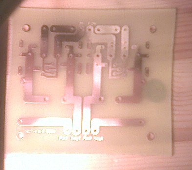

This is how the transfer looks after peeling off the paper. With
ligth like this it is difficult to see any left-over paper.

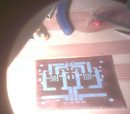

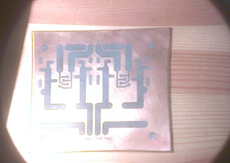

With light from the side, things change a bit, and any traces
of the BilTema paper show up as white under this condition.
Those remaining are to small to be seen in the photo, though.
Note the difference in brightness and colours compared to
previous image.

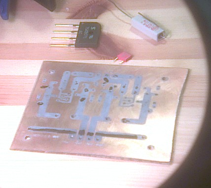

This is the board after etching, but before cleaning. Note how
the both the toner and the paint survived the etching. Be
somewhat careful with too hot water and acrylic paint, though.
It can start to peel off if the water is too hot, but then it is
probably too hot for etching too.
