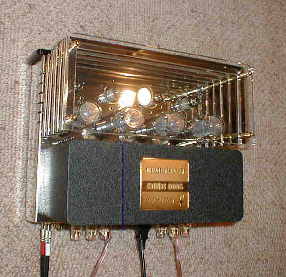

Gunther,
I would suggest getting a MingDa MC34B. This is a 20 watt/ch integrated with two selectable inputs and volume control. Uses P-P UL 6L6's. I have one and have *upgraded* it by installing a set of old Mullard EL34's. This amp won hands down with the stock Chinese 6p3p (6L6 equivalent) output tubes installed, when tested against several other more expensive tube amplifiers in my own listening tests.
IMO this sweetheart amplifier cannot be beat for value and the performance can match amplifiers costing many times more. I am not using it because it is inexpensive, I am using it because it is one of the best sounding tube amplifiers in my home. It is also the quietest.
I can be of assistance in you getting one if you want my help. Send PM.
