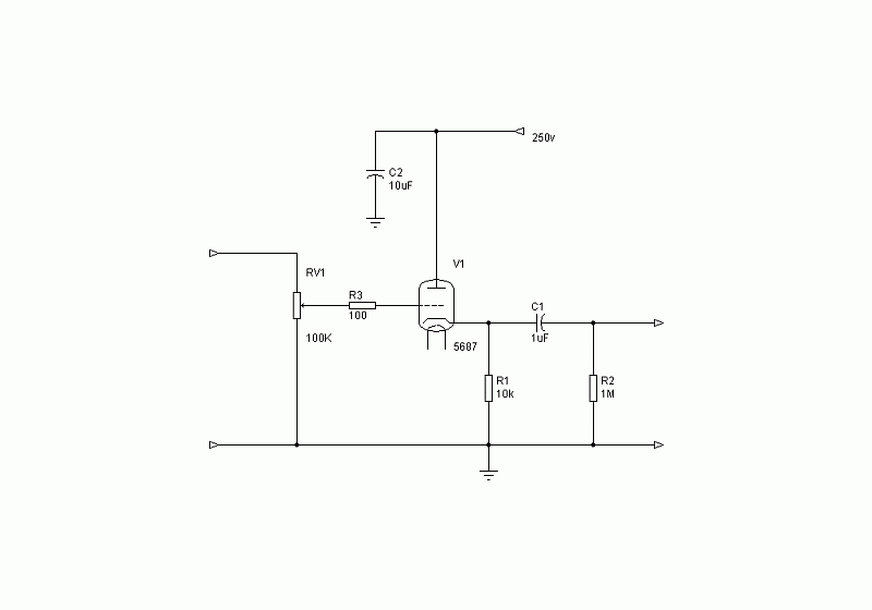

Hi all,
I've decided that I need to build a Buffer linestage instead of a plate follower linestage since I need no gain. Merely impedance matching. While I have designed plate followers and understand how tp bias them this will be the first cathode follower circuit I have tried. I would like to bias the 5687 at 20mA (a cathode follower sounds better at high current from what I understand) but I'm not sure about how to calculate the cathode resistor in order to achieve this. Would anyone care to give me a lesson in cathode followers? Pretty please.🙁 🙁 🙁

This is a type of cathode follower that naive builders have done many times and has given CFs an undeserved bad reputation. You need to be dropping some serious voltage across the cathode resistor, and that means either returning it to a negative rail or biasing up the grid with a voltage divider and capacitively coupling the input.
Let's say you want to go the negative rail route. And you've got -200V available. If the grid is roughly at ground, the cathode will be roughly at ground (within a few volts). So for a desired current, you size the cathode resistor according to Ohm's Law. Want 20 ma? Then for a 200V drop across the resistor, R = 200V/20ma = 10kohm.

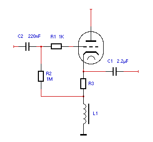

The best way to hook up a CF for a buffer in a pre amp is the old fashioned way of using a good quality choke IMHO. You don’t need 20 mA, 5 mA to 10 mA will suffice. The idling current depends largely on the load resistor which is usually high ( >100K ).
Cheers 😉

The circuit that Pjotr provided is an EXCELLENT starting point for a buffered volume control.
Replace the I/P coupling cap. and grid leak resistor with a 100 K Ohm pot. Obviously, the wiper of the pot. gets connected to the grid stopper resistor. You can replace R3 (the cathode bias resistor) with a stack of 3X red LEDs. Such a stack places the cathode at a "perfect" 6 V. above the grid. The full 2 V. RMS O/P of a CDP is 5.66 V. peak to peak. With 6 V. of grid bias, a CDP will not clip the grid circuit.
The inductive reactance of the loading choke at 20 Hz. should be at least 3X Rp. A good alternative to a loading choke is a constant current sink (CCS). You can construct a CCS from either a MOSFET or a pentode. In pentodes, the 6AU6 is fine for modest current, while the 7054 is good for currents too large for the 6AU6 to handle. A single "bottle" solution to a CCS loaded CF is the 6BM8. The triode in the 6BM8 is 1/2 a 12AT7. The power pentode in the 6BM8 will LOAF at 12AT7 currents.
Increase the O/P coupling cap. to 4.7 muF., as that value accomodates low (10 K) I/P impedance loads.
I guess I should have been more specific about my needs. I am using a Parasound preamp with my SE EL84 amp at the moment. I drive the amp and a M&K subwoofer amp with the preamp. I wanted to go all tube but I was concerned that a anode follower circuit would not drive the two parallel loads (plus I don't need all of the gain). THat is why I wanted to use a buffered volume control. With the low output impedance of a buffer I wouldn't be concerned about the lower than optimal load that it would be operating into. I may have this all wrong and my original preamp circuit would work fine. Opinions?
Gavin
Your SE EL84 amplifier probably has quite a high input impedance, but what's the input impedance of the M&K amplifier? There's no point in having a wonderful CCS or choke load if it's shunted by an amplifier having 5k input impedance...

Gavin,
Stop giving yourself a headache. The O/P impedance of a 5687 CF is < 150 Ohms. The rule of thumb is that the device(s) being driven should have a net I/P impedance at least 10X of the O/P impedance. I seriously doubt that the M&K SW's I/P impedance is as low as 5 KOhms. The IHF "standard" is 10 KOhms. I would expect a reputable company, like M&K, to meet or better the IHF "standard".
BTW, TDSL shows the 5687 with Ua = 180 V. and Ug = -7 V. to have an Ia of 23 mA. A 150 V. Ua and a -6 V. Ug from 3X red LEDs will be awfully close to the 20 mA. you want. If you use a 20 mA. CCS, 3X red LED bias, and a 225 V. B+ rail, things will fall into place "automatically".

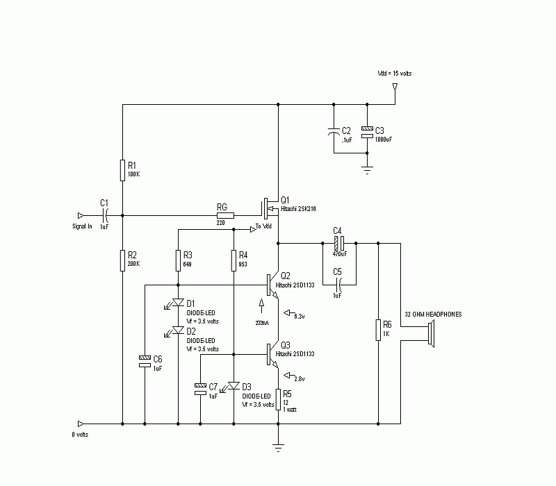

Acouple of years ago I designed a headphone driver that used a current sink. I have since forgotten the specifics but I suspect the current sink will work for this application with a few changes.

Hi Gavin,
Think the headphone amp will suit your needs perfectly. But I would make some modifications. I would set the current trough the given fet at 10-20 mA max and lower R2 too 200K so the gate of the fet sits at 10V. Also R3 an R4 can be much higher, 5 mA is more than sufficient through the leds. For driving long cables I would put a resistor of 220 ohms in series with the output caps. This eliminates any possible oscillations due to capacitive loading (this also holds for a CF).
This circuit will work great but given you are driving maybe 5V max. and have 250VDC to spare, a resistor instead of the inductor will save time.
Tim
That’s true, but then I would choose a resistor large enough to have 50 – 100V DC at the cathode. Then the resistor acts more or less as a constant current source. Disadvantage is that the DC voltage at the cathode drifts when Gm drifts due to ageing but that is not a big disadvantage. The advantage of a choke is that the cathode can swing large amounts below ground without a negative supply and still the bias current can be high.

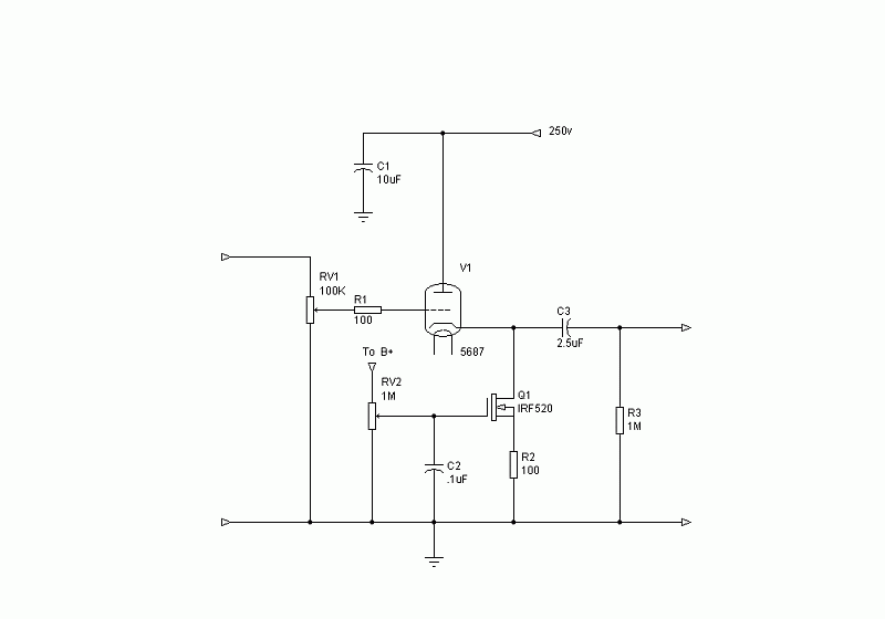

Eli Duttman said:
G.,
The CCS doesn't have to be as sophisticated as the 1 in your headphone circuit. A high working voltage N channel enhancement MOSFET will do the job. Put a 100 Ohm resistor (as a test point) between the source and ground. A 1 MOhm pot. between B+ and ground with the wiper connected to the gate forms the adjustment. Start with the gate at ground and raise the forward bias until the drop across the 100 Ohm resistor is 2.0 V.
BTW, a well regulated power supply is in order. A "simple" choke I/P filter will get the job done.
I believe you are talking about something like this. I suppose I would use LEDs to bias the FET once I figure out the voltage needed at the gate though.

G.,
The most recent schematic is very close. Assuming a well regulated B+ rail, C1 is unnecessary. R1, the grid stopper, should be 1 KOhm Carbon comp. You need to provide -6 V. of grid bias; either a stack of 3X red LEDs or a 300 Ohm resistor in the line between the 5687's cathode and the FET's drain will do the job. The "bottom" of the 100 KOhm volume control gets connected to the FET's drain, not ground.
